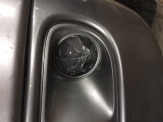

Found my driver's side fog light lens shattered on my '02 4Runner yesterday, while leaving work. Vandalism or well aimed road debris... I guess I'll never know.
Light still works, does anybody know if you can just replace just the glass lenses on these and if so can anybody provide a part #? I was only able to find the part # 81221-35030 for the lens and housing. Thanks

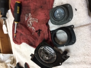

Ok so yes you can remove just the glass lens with a gratuitous amount of pb blaster over the coarse of a couple of days and then dremeling a slot in the top of the two remaining screws that you still can't get out.
But the question remains, does anybody know the part number or where to get the glass lens for the fog light?
Please don't make me call the dealership :Cry:

AFAIK, the lens only is not avaiable.
That stinks... It seems like an easily replaceable, small glass lens which probably gets broken quite often would be something you could still get. But I've seen this question posted on the forum in an older thread and nobody had an answer then either so... guess I'll post a WTB in the classifieds
