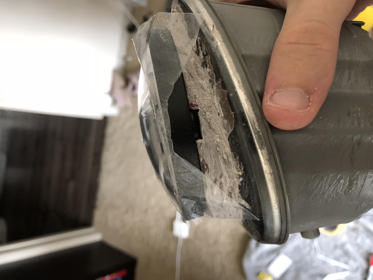

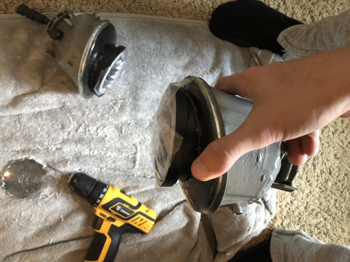

My plan with these was to take apart the oem fog lights and first cut a proper sized hole in the lens. Then Use fiberglass to create a level surface for these to mount to (to keep the new lights flush with the old ones). Then I was planning on using threaded bolt inserts in the fiberglass so that these can be disassembled if needed. As far as adjustments go, I was going to cut out the backside of the oem fog lights on the side opposite to the oem adjustments.
Right now I am just trying to get all the supplies I need but will have more details once they come in. Fingers crossed this works the way I am planning it to.

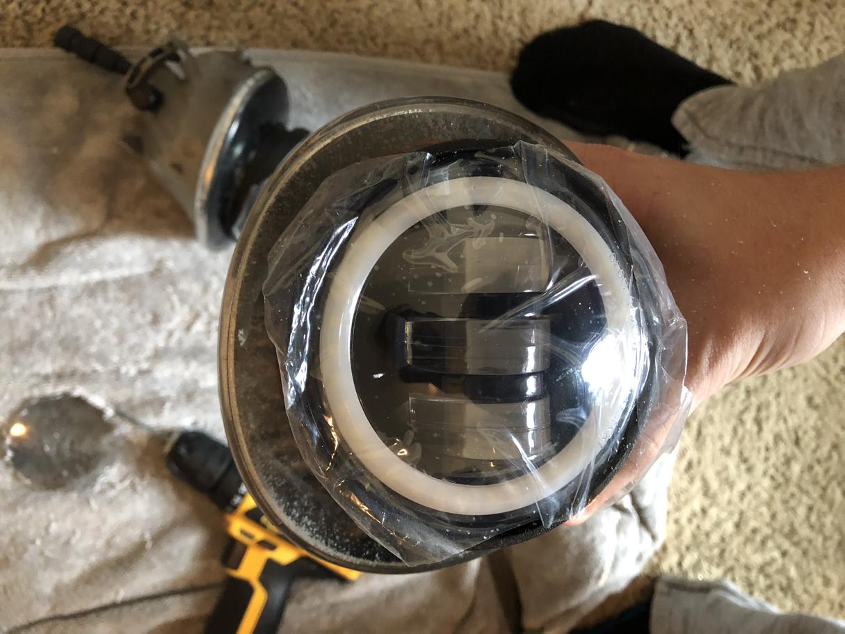

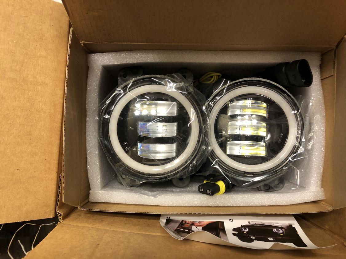

Lights came in!
The lights came in today along with a few of the other supplies I need to make this happen. I tested them and they work great! I must say they do look good :D

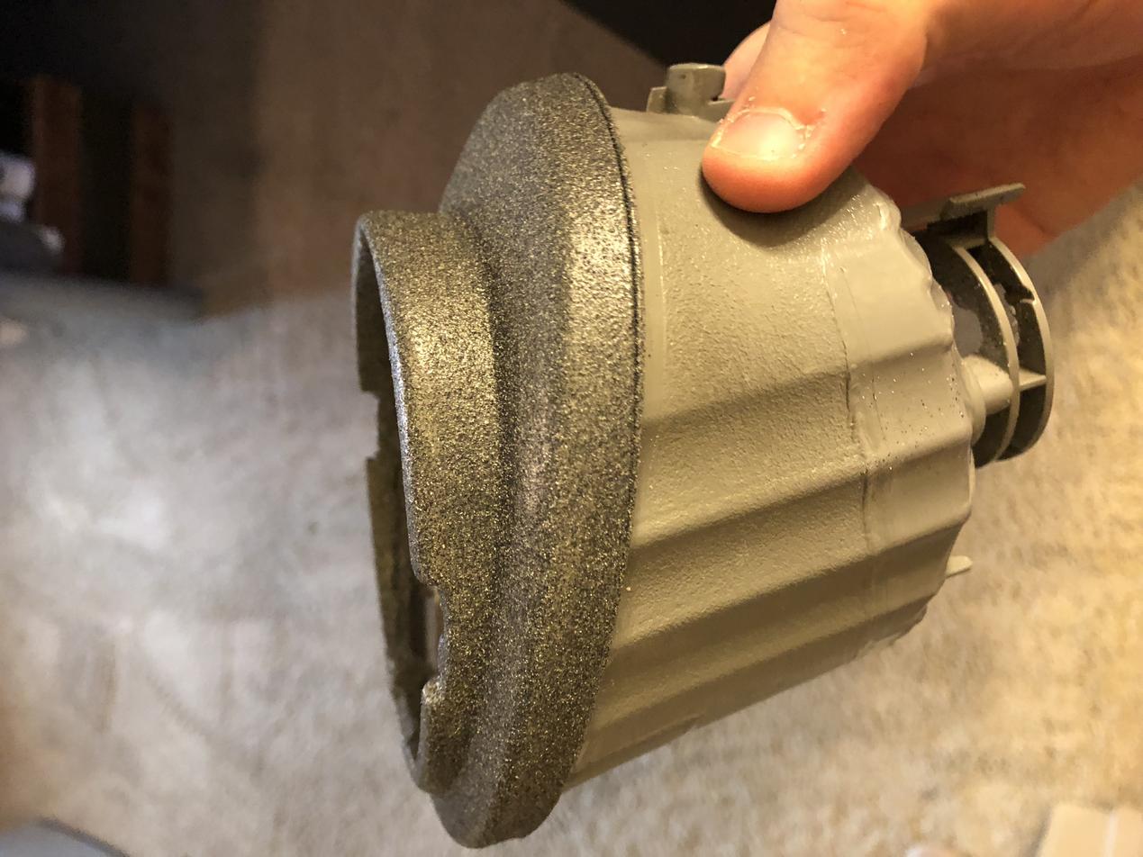

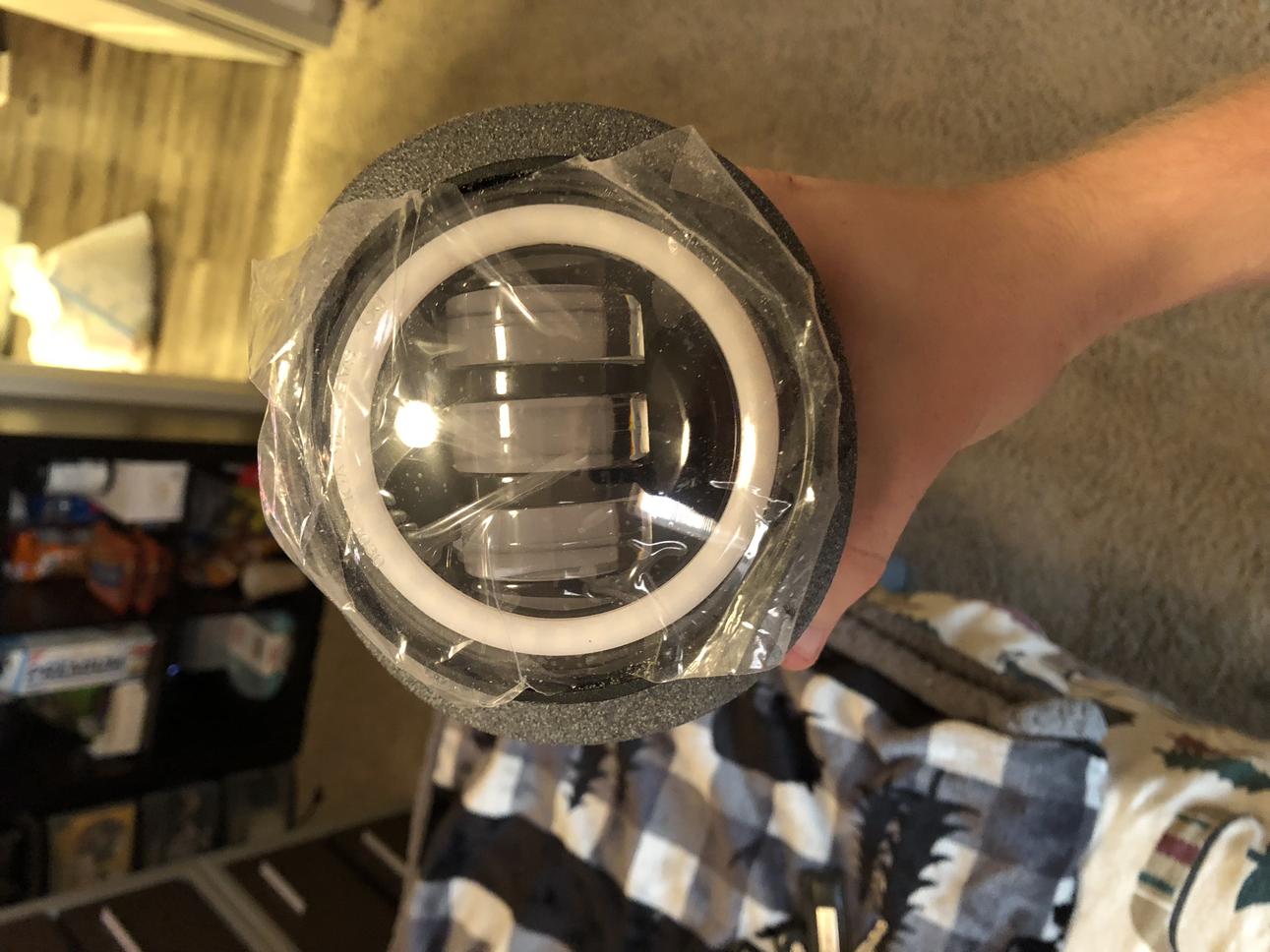

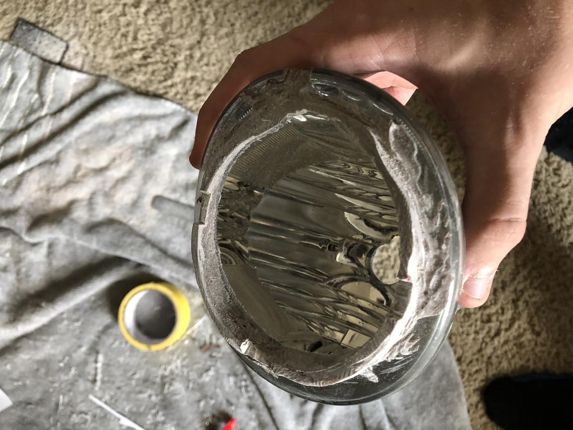

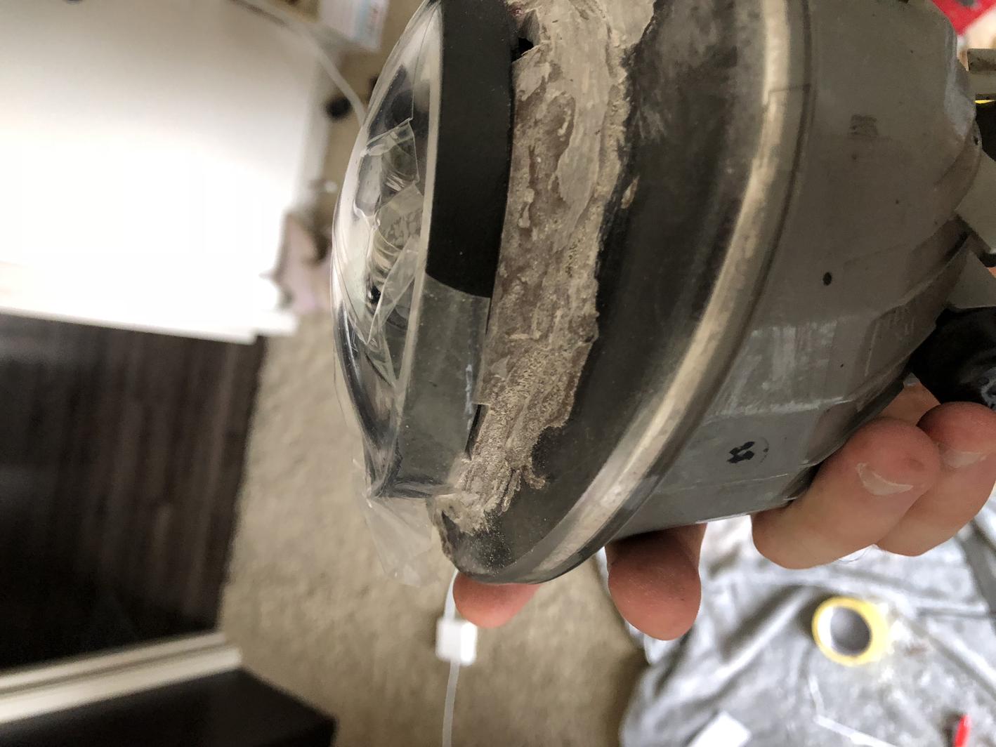

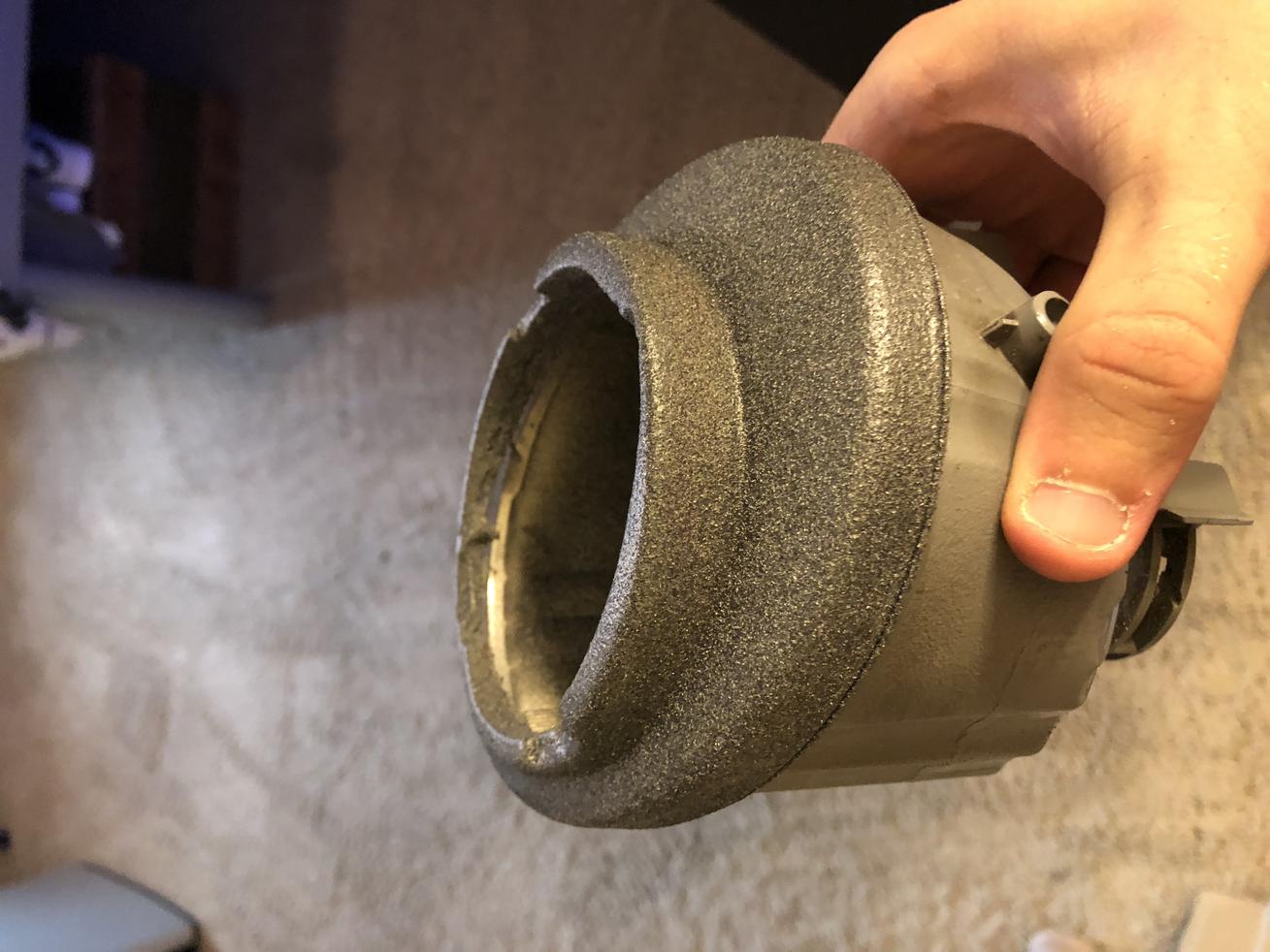

The long anticipated outcome
After a lot of fiberglass, drilling, sanding, painting and test fitting, they are finally complete. The pictures don't do it justice at all but it looks amazing
