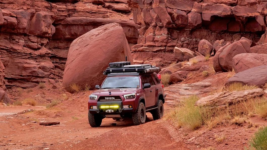

I run BD fogs…plug and play for the most part. I don't remember since its been awhile, but it might be a bit easier to install if you remove your front bumper.
another +1 for baja. you do not have to remove your front bumper and you don't need to go through the fender liner in the wheel wells to install. if you have some patience you can do it from underneath by removing and unbolting some of the plastic pieces below the bumper.
fender liner is probably the easiest though just get some extra plastic tabs (4 of them on the 2010-2013s) because the self tapping screws don't like to seat nice and tight in the plastic when trying to reinstall them.
