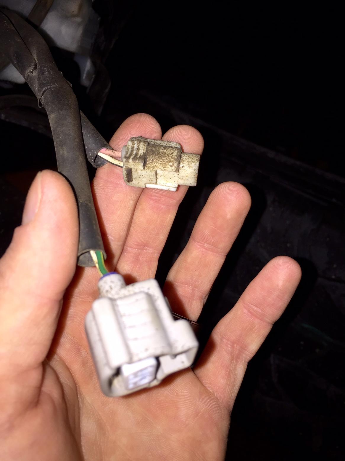

well i checked and theres no relay between the fender wall and the battery..i also checked where the relay plugs in and its lighting up at 12v...so thats good
i then pulled the lights out of the sockets...the sockets werent putting any power out...and i also saw this other wire tapped into the fog light wiring for each light..not sure what the heck it is(picture below)but its just dangling
just weird that there would be fog lights on the truck with the bulbs in, wired and ready to go but not operational and no relay...
guess ill replace the bulbs and get a relay but dont think thats gonna do anything...dunno what else to do..wish the switch was on the stalk

The lack of a switch in the stalk, and the empty fog light plug in the fender means the installation is not factory and you are 100% wasting your time looking at the factory relay location and the factory fuses as they were almost certainly not used. This is why I asked the question.
PO could have done a million things, each one stupider than the next, including just tapping a headlight wire and not using a relay (should blow a fuse, though). Try to trace the foglight 12V+ supply wire. Since it is an aftermarket install, that should not be that hard. Look hard for a switch, because few install fogs without one.

This is almost assuredly the case
i still have yet to find the relay...i looked in between batt. and fender wall with no luck...ill go look a little later and take some pics..hopefully this time i dont step on a bulb:guitar3:
Follow [MENTION=10169]TheDurk[/MENTION]'s advice (he guided me in my dilemma) and trace those wires. Final option would be just to rewire the whole darn thing so that you know exactly what's going on. Could even use the stock relay's in the fuse box. This is something I'm going to be doing real soon myself.
