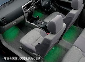

Anybody know about these footwell lights that are optional on the Japanese version?

Carson Toyota has the JDM footwell lights for only $109. Here is the link: http://www.newtoyotaparts.com/product/?id=1200 I'm posting this because I hope that someone will now buy them and tell the rest of us how to wire them. Here is a larger version of the pic that is in the second post:
