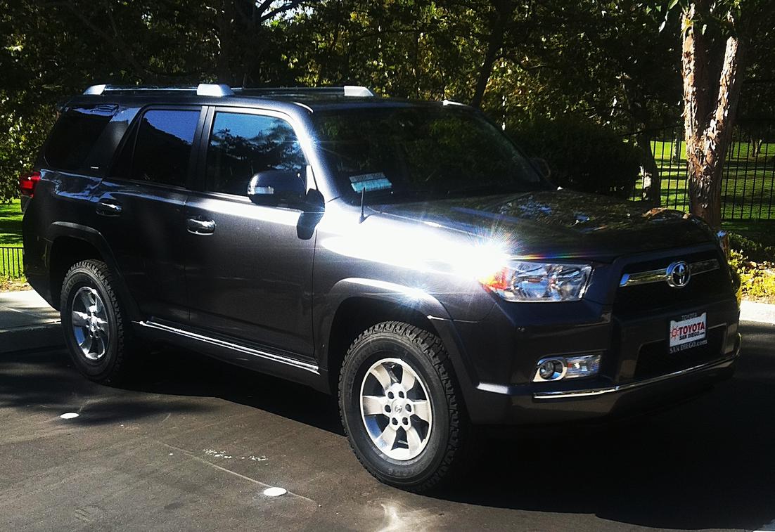

I just put them on at the Firestone shop today for a great deal. $230 after tax and everything which included labor and a 50,000mi protection plan. They gave me the full retail value credit for the sorry Bridgestone Dueller HT's... but since you have Dunlops, I doubt they'd be able to do that deal.

Thanks ImOnAPlain...it actually looks even better in person, my phones camera isn't the greatest quality.
