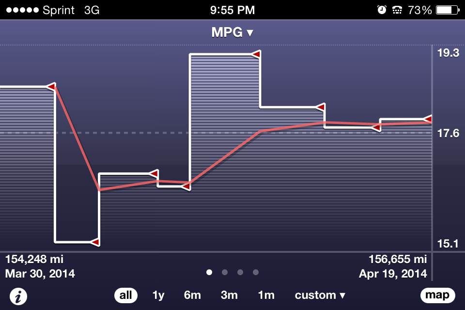

To start. I only started keeping track of my fuel economy after I installed my 63 series K&N intake for the V8. I have no data to suggest what I might have been getting before hand, and the general consensus is the on-board mpg calculator is off by a few numbers.
Originally I had intended this to show possible gains with the intake installed. The readers of this thread could make their own judgement on weather it might be a potential upgrade if your looking to boost MPG. After all there are a number of threads on the forums regarding that topic.
What ended up happening during my logging of this information was a realization that octane rating has far more to do with MPG than I thought.
The first data point is using 87 octane. The next 3 data points I used 86 octane. Clearly there was a loss . The high point was using 90 octane. This was a substantial difference from the 86. The last 3 data points and what I am using now is 88 Octane.
What does this mean? It may be more beneficial to fill up with higher octane (90 if available) than attempt to purchase aftermarket products that may or may not work.
Its a little hard to quantify the difference between MPG gained / money spent to buy more expensive fuel but you can probably figure it out with your local fuel prices.

I have tried higher octane on 2 separate highway trips and noticed zero difference in mpg. I'm not saying you did not notice a gain as I do not know the condition of your 4runner or the type of driving performed for these tests, but there are so many variables (temp, average speeds, start and stops etc) that it is difficult to get accurate test results. For the most part you will see little to any gain with higher octane unless your engine is a little dirty.
its the gas, not the filter
K&N filtercharger won't do a thing except put a smile on your face. I've had them in the past. I would never install them again, but that's me.
Anyway, don't forget the the 1GR-FE does detect what gas you are using and adjusts the performance accordingly.
