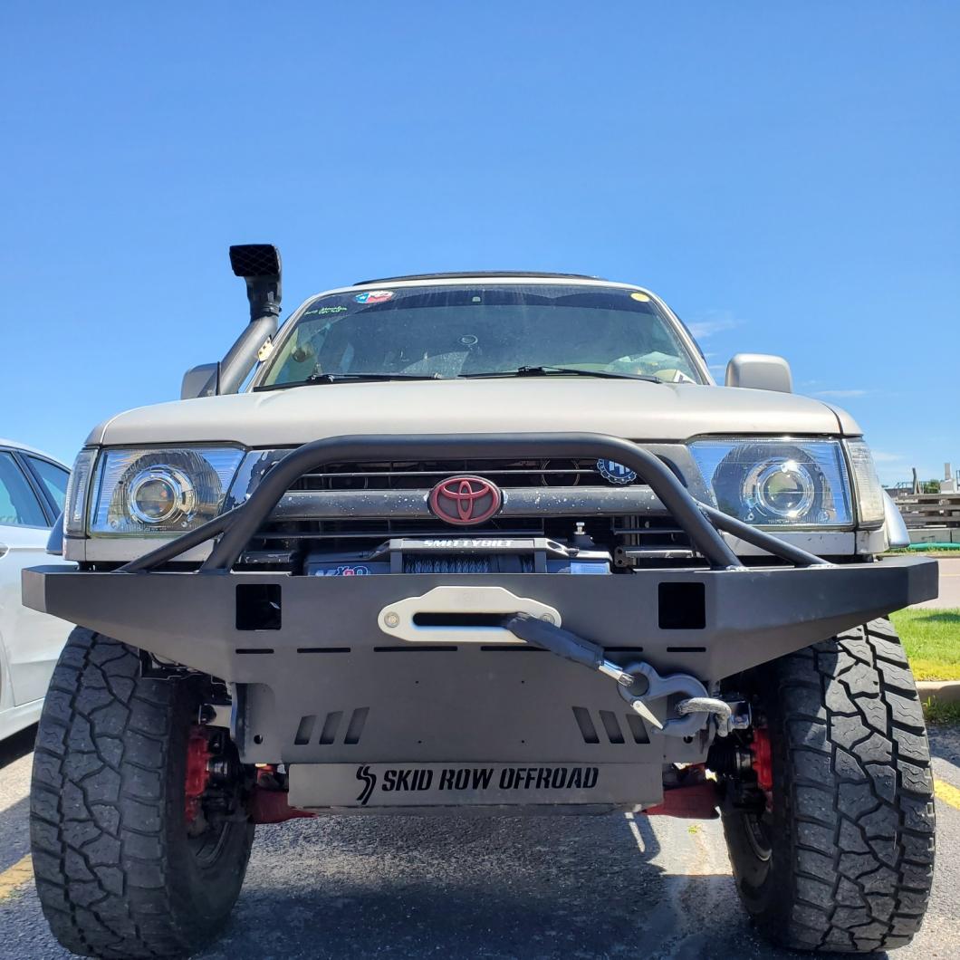

So you ARE on the forums haha. I used your video to build mine and it came in extremely handy. Did a couple things different, but overall the video was spot on. Thanks for putting it together.
