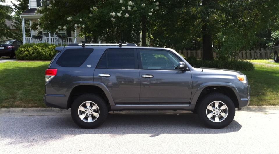

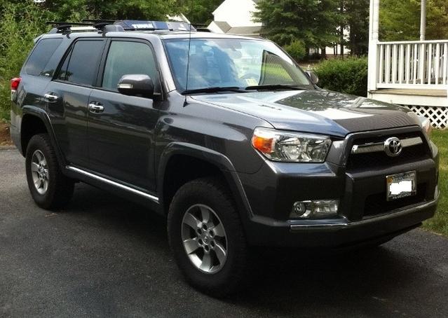

I installed 2" toytec spacers in the front and 1.5" spacers in the back...still have a slight rake and it rides great. Also looks good with 265/70/17 terra grapplers. Once I spend the big bucks on a full suspension overhaul...the big tires will be a necessity. but for now, this lift makes the 4runner look a bit more aggressive...and it is easy to install. Hope this helps anyone looking at this option - I had a tough time finding pics of people who have done something similar...most were the 3/2 lifts...

It does look good. Very subtle.

Here is a good picture from the side...I do believe bigger tires are needed! Again, I know this doesnt compare to some of the bigger lifts on the site...but it is a start!
