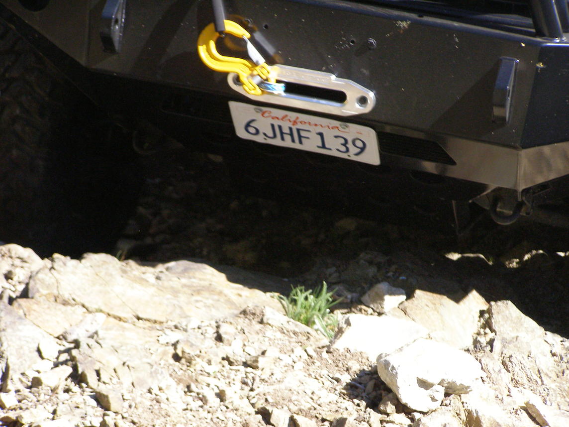

For those with a Shrockworks front bumper & a winch..
The feet to the winch bolt to the back side face of the bumper. You will have to open the winch up and turn the lever setup. The line feeds from the bottom.

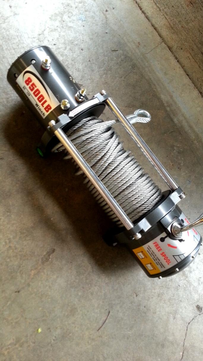

For reference, this is the winch I have. I'm hoping that it's not too big..

As long as the bolt pattern is the same, it should work. Just going to have to turn the handle section a 1/4 turn to be able to access the handle through the cut out spot.

The winch is going to be mounted on it's side if you want to imagine it that way. If you tipped that guy backwards 90*, you'll see 4 bolt holes in the front of the bumper that will line up with it's feet. I also clocked the clutch an additional 90* so it ended up facing downwards like the other folks have said. The winch itself doesn't connect to any type of bracket, just straight on to the bumper.
