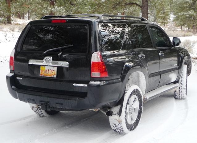

Now that it has warmed up I am going to move the exhaust so I can ride with the rear window down. I am going with a single 3.5" stainless tip behind the passenger rear wheel. Once the resonator is chopped off the last exhaust hanger is going to be useless. Have you guys had a new exhaust hanger made or do you just let the pipe hang? Seems like you would have to use a new hanger to keep the pipe from bouncing all over the place. Can some of you guys post some pictures of your setup? I want to make sure my exhaust guy gets it right. Thanks.

Everyone I'd talked to had, I just didn't have any luck. Mine comes out at about a 45 degree angle, I think a full 90 would be required to get rid of it. I think mine's still pointed far enough back you get the smell still. Looks 10x better with the tip so still worth the money, and the sound is very nice as well. You can hear it outside the vehicle and at idle, but during driving it's never heard.
Mine was done at more of an angle. Not a full 90, but probably close. I do still get the sulfur smell sometimes, but not nearly as often. It helped a lot. I did the mod more so because I kept crushing my tailpipe when going off road. Looks better out the side, fixed my busted exhaust, and HELPED with the sulfur smell.

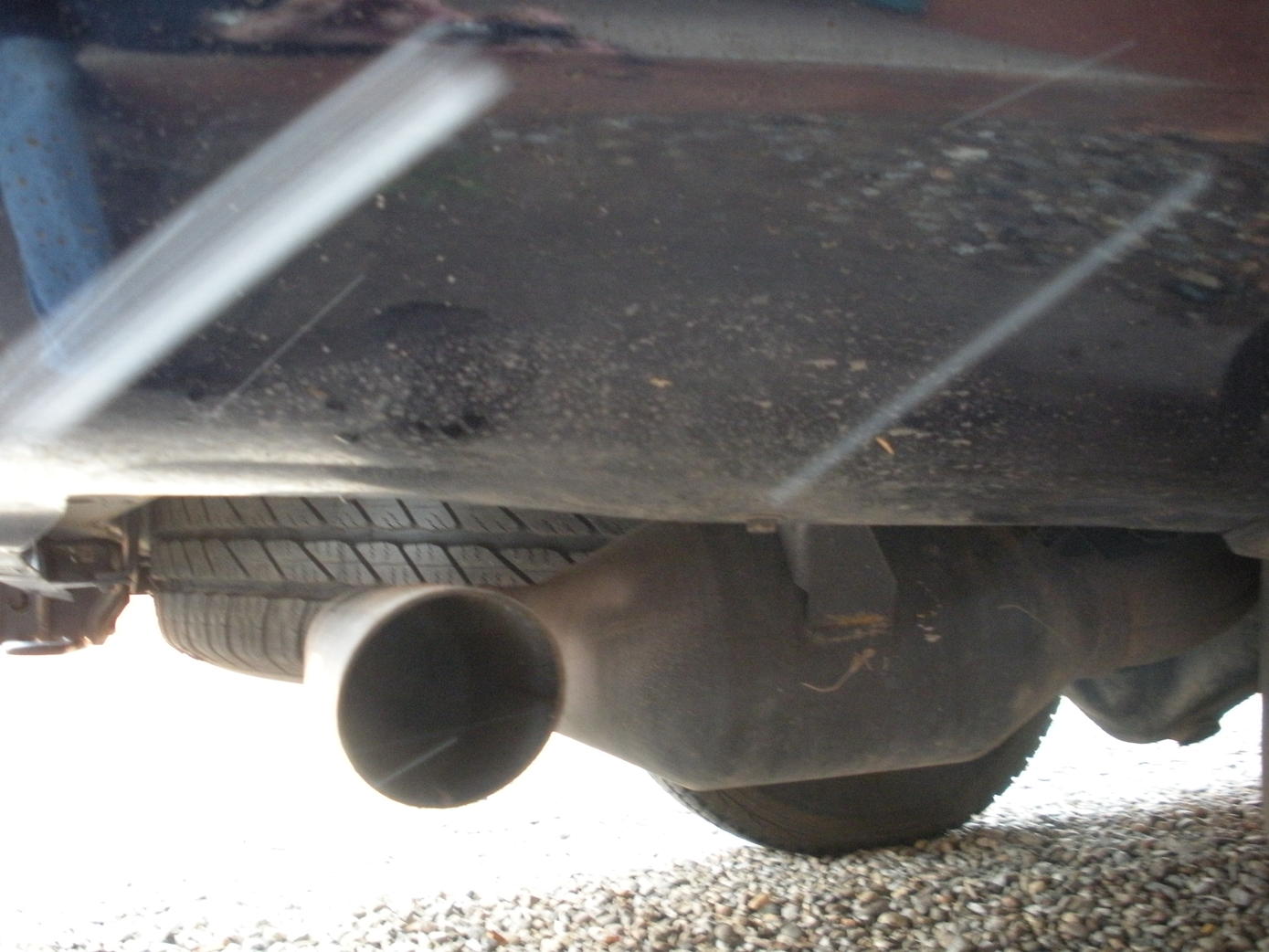

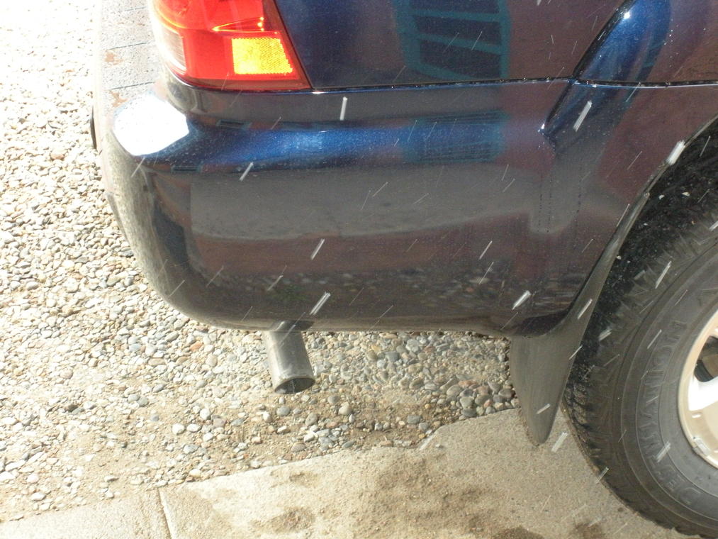

Mine exits just behind the rear mudflap. The piece of pipe I used was part of a downpipe (right off the turbo) from a 6.0L Ford Diesel. The tip is a Magnaflow oval left over from a different vehicle cat-back. I made a new hanger from a long u-bolt left over from some lift kit. I have no more sulfer smell inside the 4runner anymore. Haven't tried it with the window down as I never roll it down. Thought I had a better pic of this but you get the idea.

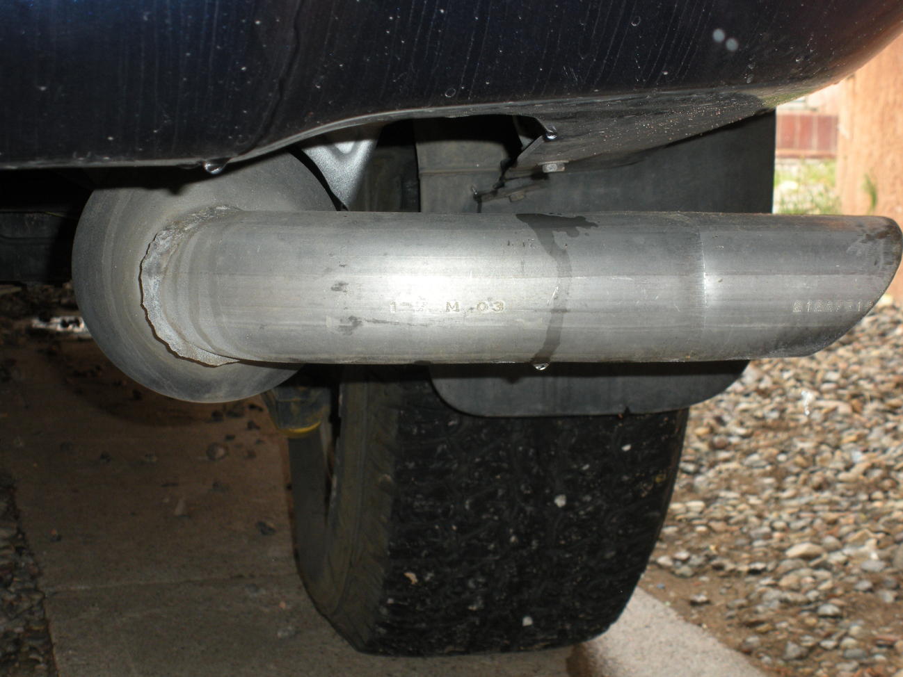

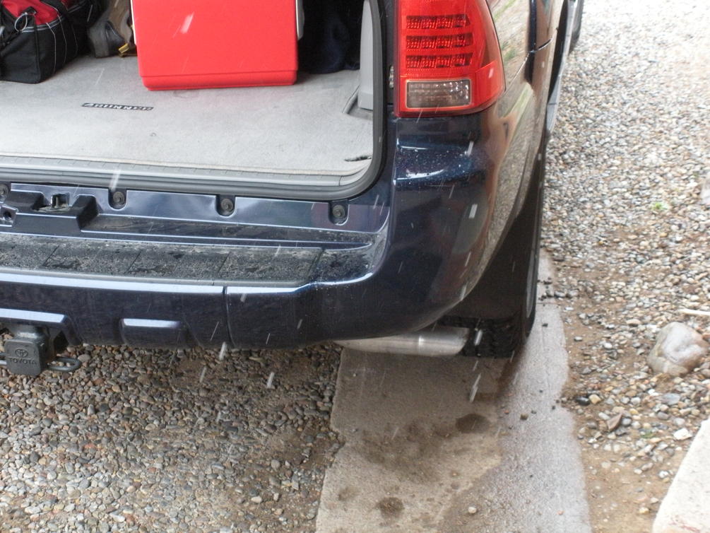

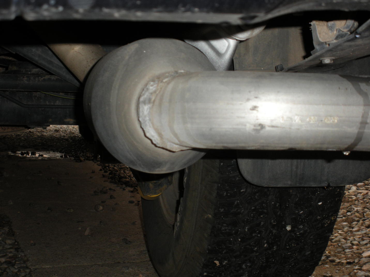

here are some pics I took this morning:

<p>Here is my Side Exhaust Mod on my V6, completed just today. The shop did a beautiful job. As you can see, the welding quality is excellent. He was able to reuse the old hanger, as you can see.
I went with a Silverline stainless steel tip.
<p>The cost of the job was only $80 plus tax, about $87 out the door. $60 for the tip and $20 for the pipe and labor. This was done by Performance Muffler in Phoenix, AZ, BTW. All in all a great value, IMHO.
I haven't driven it a lot yet, but it seems only very very slightly louder -- not much difference. Sorry about the weird reflection from the sun in the second pic.
