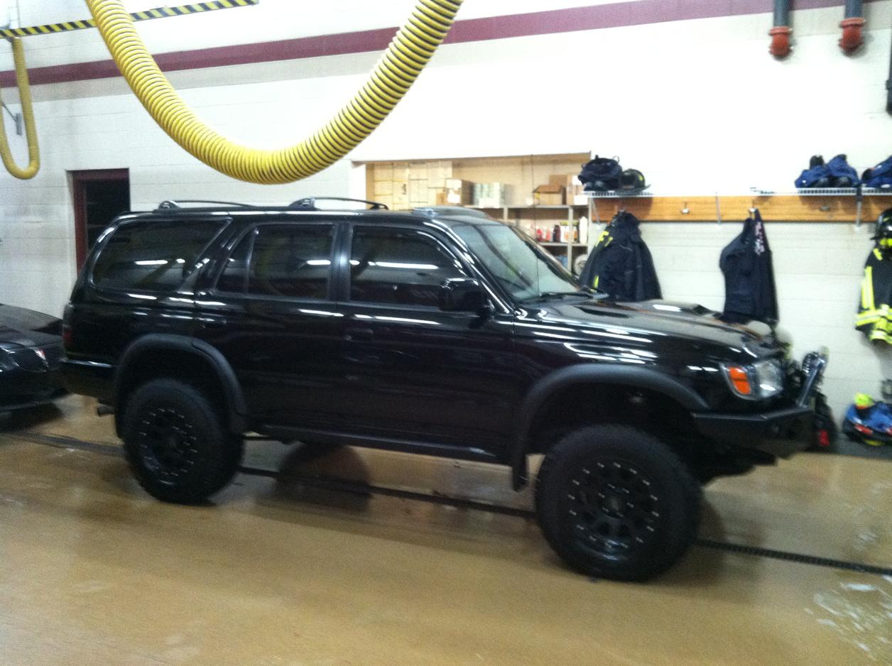

Ok, so I didn't document much change, but none the less. Here is a short and sweet in progress build thread.
This was fireball's and Mboytin's previously owned beautiful 99 highlander ed .
They took good care of it so i wanted to continue the trend.
I removed the old suspension, and replaced it with a toytec ultimate lift with OME 906/ Bilstein 5125 in the rear.
Removed all the old mats, and put in all weather tech mats.
Replaced all the old wheels, with new fresh alloys.

Suspension is set up so it sits level with no rake about 2.5 in the front and 2 in the rear.
Diff drop 1"
This is to make sure all the mods are worth it and will last.
