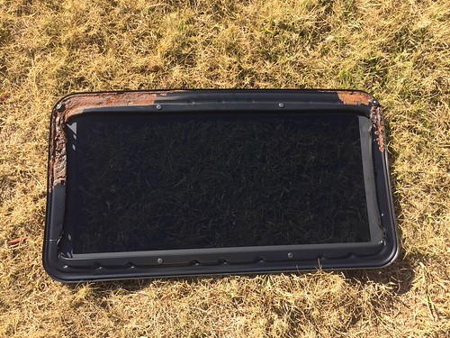

Picked up a 2008 SR5 Sport this week and there was rust on the forward (leading edge) portion of the moonroof glass frame and a portion of the L and R sides. Looks like it started in the forward L and R corners, then spread from there. Rear frame corners, rail and rear portion of the side rails were fine. Picked up a used assembly and just used the glass from it. Now I have an extra assembly and motor if I ever need one.
Based on the drain layout within the assembly I have 2 theories about how this might have happened. 1) Both forward drains became clogged at one time causing the water to pool in the forward corners OR 2) The previous owner regularly backed the vehicle in on a sloped parking space, such as a driveway, putting the T4R at an angle that interfered with the function of the drain system enough to cause rain water to pool towards the front. I'm leaning towards #2 because it seems the odds would be high that both front drains were clogged at the same time for such a long time to result in rust.

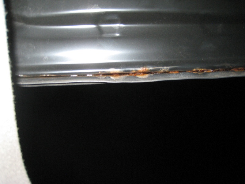

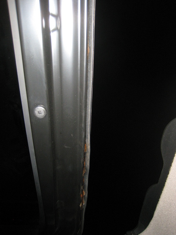

Any pictures of the rust? I can't see any around my moonroof but I'd sure like to be proactive if it's somewhere I'm just not seeing.
Here you go:
Thanks! I took a look at mine today and rust is forming under the seal...I can hear it crunch when I press on the front of it. I guess I'll try to pry the seal up as much as I can, wire brush it off and hit it with some rust converter. Too bad that seal is permanently stuck.
Here's a couple pics of mine...
