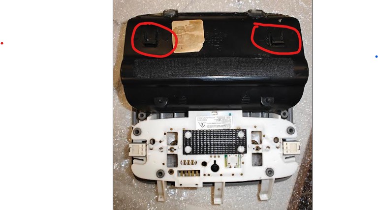

Has anybody ever successfully repaired those plastic tabs that hold the dome light in the frame? I tried velcro, but the glue seems to be too weak to hold the full weight.
I got a replacement online, but probably due to it's age, it didn't last very long either, and finding the right combination between color, sun roof, and homelink is not that easy.....

they have metal clips.
90468-05125
make sure the holes in the roof is not bent out of wack, straighten them out.
also if you want, try camry homelink off ebay, not sure if you have sunroof. but the roof console fits just fine.
install metal clips and apply some glue and let it dry before install. i usually use a dab of super glue and some accelerator to promote faster setup.

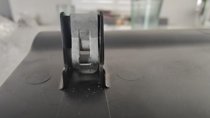

Usually those metal clips are on top of plastic taps. Those plastic tabs are broken off (and yes, the metal clips stayed inside the vehicle...).
Are you saying just glueing the metal clips to the bottom of the plastic is sufficient even with the plastic tabs gone?
Are you saying just gluing the metal clips to the bottom of the plastic is sufficient even with the plastic tabs gone?
Just had a look at a similar one, the metal clips are above the bottom, so the distance to the hole would not be correct even if I was able to glue them to the bottom.

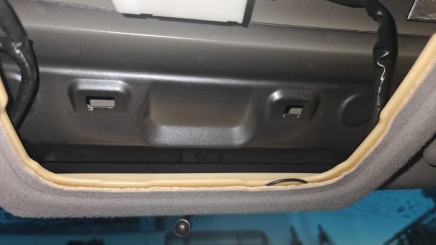

if possible, show us a picture of the current condition of the roof area, also where the attachment point is.
Sure!
Attached is a picture of the current condition of the attachment points in the roof.
