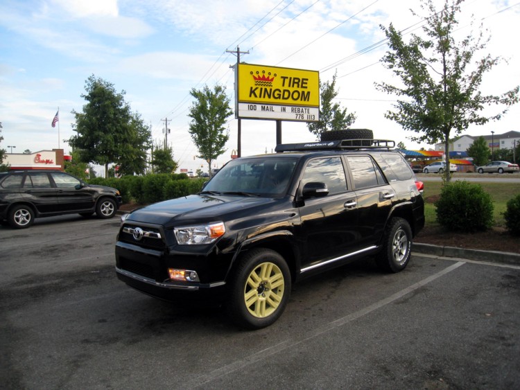

Put on my SR5 rims (THANKS adio3x) and BFG 275/70/17ATKOs last Thursday just before leaving on an 800 mile trip with the wife. The tire place took three and a half hours to mount and balance them!! I remained VERY patient. Finally done, and BAM my truck finally looks like a truck! Sweet! So, we hit the road. About 30 miles in, I noticed the truck pulling to the left. So we pulled over. Front left tire had under 5 psi in it. The other three had lost about 10 psi already. Well, THANK GOODNESS I just installed my ARB onboard compressor last week. So, I pumped the front left back up and it was definitely leaking on the valve stem. So, I took it off, mounted the spare on there (unmatched), pumped up the other three to about 40psi. Then drove to the next Tire Kingdom shop, which was about another 40 minutes down the road. They took them off and noted that their guy at the other store had done a horrible job. He had transferred my valve stems to the new rims and failed to put in the rubber gasket, or just didn't do it right...resulting in FOUR leaky tires. (PSI in the other three was under 20 when I arrived there around 7pm). The technician went ahead a pulled all four tires and re-mounted and re-balanced them with new valve stems. Then, they broke a lug!!!! $**%*!!!! At this point it was 8pm. They replaced my lug and we went on our way. See pic! It is important to note that one should always check the valve stems on their new tires after they have been installed. It is easy. Just put some soapy water on there and see if it causes bubbles. If it does, take it back and make them do it again!!!!!!!!!!! I know this is a bummer, but I was pumped to get to use my ARB onboard comp, AND throw that tire up on my new Baja Rack! Without the compressor, we might not have made it to the next stop.

That is unbelievable! Did they offer you some money back or a maybe a cash card towards later purchases? If you screw up that bad, you need to make some effort to show the customer you will make it right in the future. On a side note, the limited spare is yellow?

What's up with the picture? Did you paint that wheel?

I put 2010 SR5 rims on with BFGs, but I didn't change my spare. The 2010 Limited's have a green/yellow paint on their full size spare wheel. I intend to switch out the spare with an SR5 wheel and another 275/70/17 tire at some point.
I live in Charleston, SC. That pic was taken in Columbia, SC at the Tire Kingdom off of exit 9 on Hwy77. Headed kind of your way to Lake Jocassee in October. Hoping to get up in the mountains too...do some fishing in some more remote streams hopefully.

A little-known fact that happens at Toyota dealers across America:
When your 4Runner is in for service, many techs (especially the shorter ones) will deflate the front tires completely to make it easier to reach in under the hood. So your 4Runner's weight is basically on the inner and outer wheel rims, resting directly on top of the deflated tires.
I've seen that hundreds of times when I worked as a Toyota technician. I never did it myself because I'm tall and don't have any issues reaching anything. But like I said, a LOT of guys do it whenever they work on a 4Runner or a Land Cruiser.
