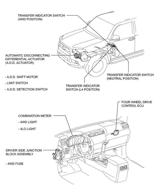

In the repair manual under problems/symptoms table ....it gives these 5 suspected causes and how to troubleshoot for each. I suspect ADD actuator or 4x4 ECU.
VF2A Problem....Shift from 4WD (H4) to 2WD (H2) is impossible
Transfer indicator switch (for 4WD position)
A.D.D. actuator
Harness or connector
ECM
Four wheel drive control ECU
