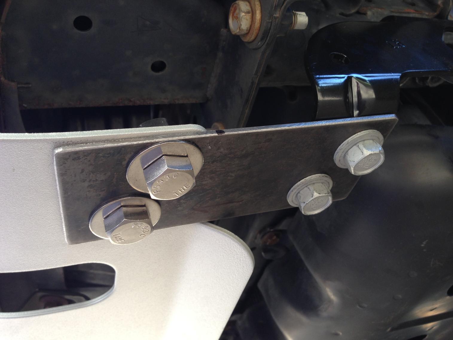

Added the Taco chin spoiler with modification I got from this forum.

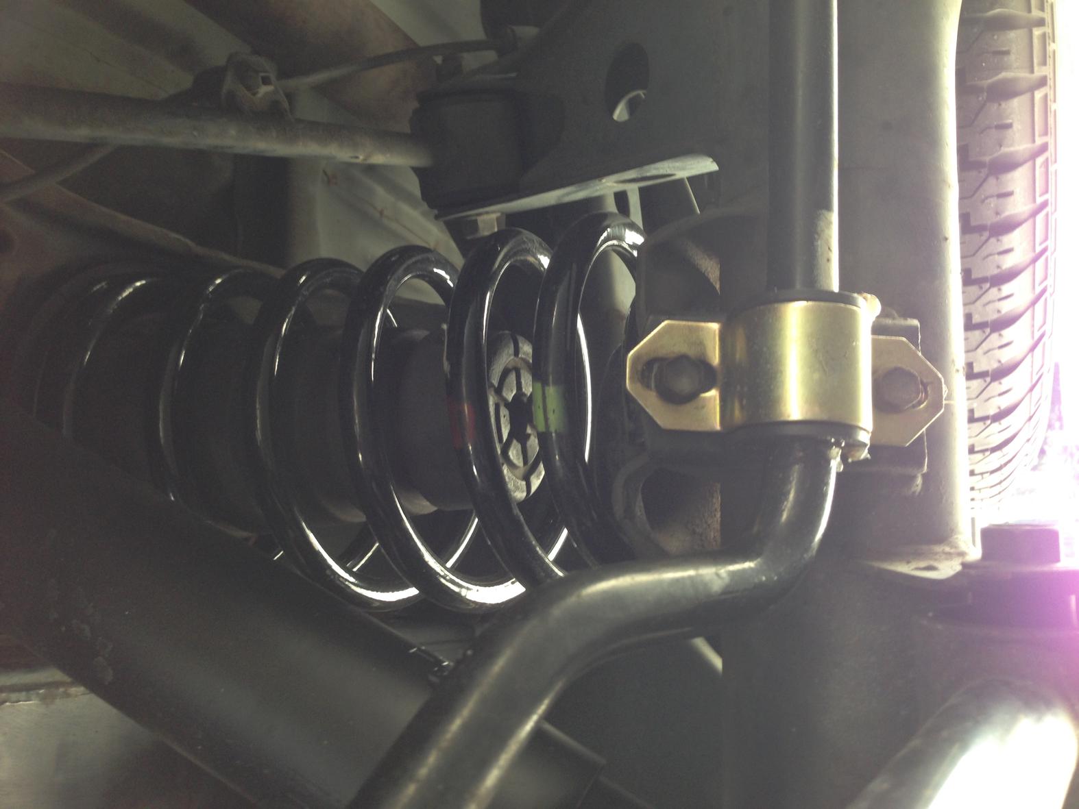

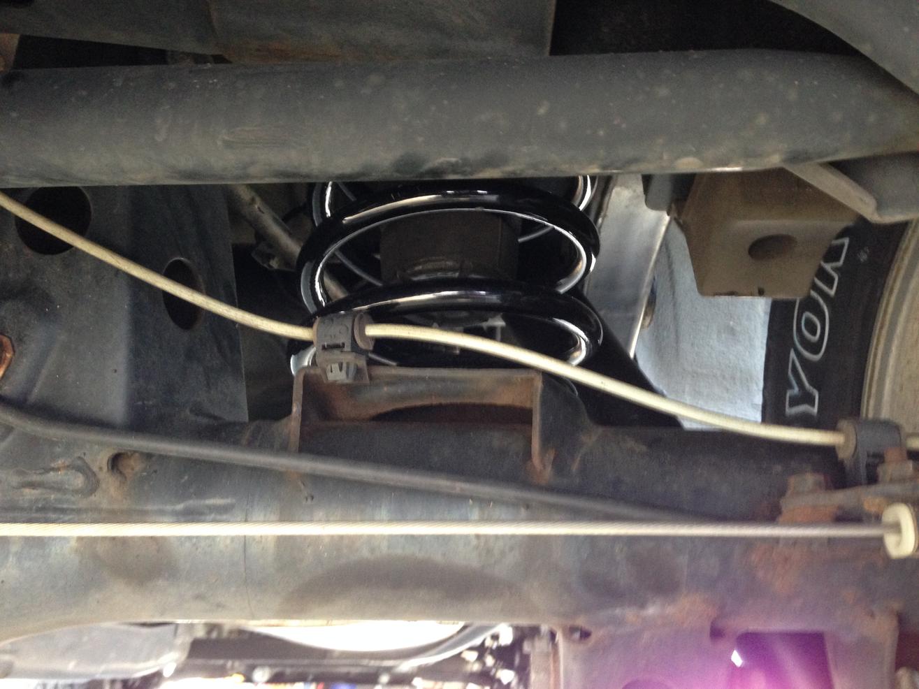

On the rear I put in 99 Highlander tall boy springs, new stock shocks and poly bushings on the sway bar. Also replaced the drums and shoes Raybestos brand components. Got the parts kit with Raybestos and all those parts were perfect fits.

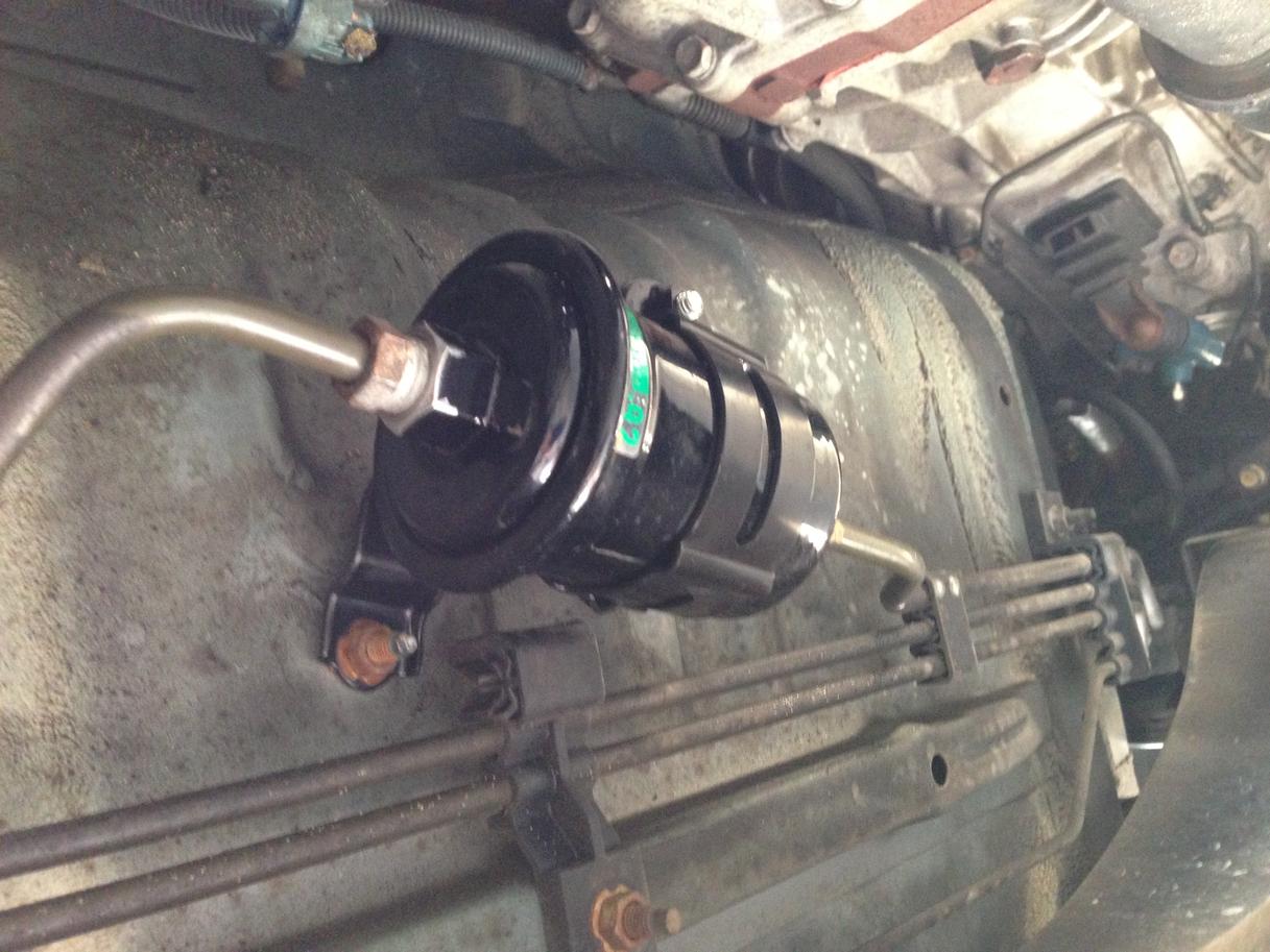

Working my way forward I replaced the fuel filter. No big deal I know but the stupid thing I forgot was to check for leaks after my 4 day marathon of maintenance and when I went for the alignment the mechanic at Toyota told me it was leaking and he got a 1/4 turn out of it to stop the leak.

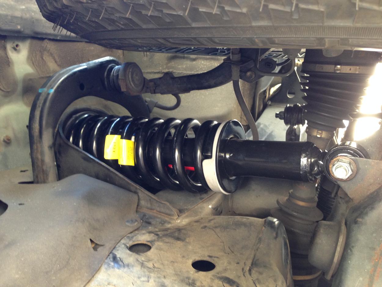

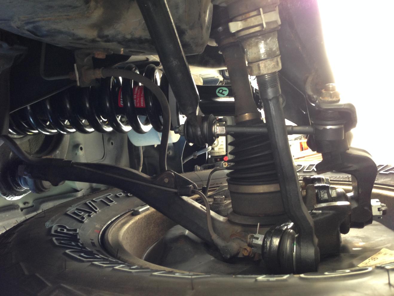

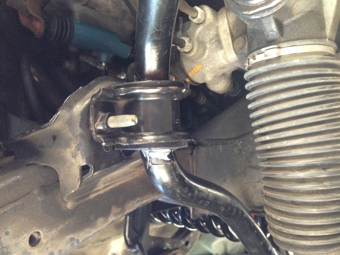

The front is where I spent most of my time.
Struts - Monroe Quick Struts (gave me a 1.5in lift)
Lower Ball Joints
All poly bushings
Tie Rod Ends
Sway bar end links
Discs and ceramic pads Raybestos again
TREs were a PITA after 14 years they did not want to move, as stated before by someone else get a 27 and 28 MM wrench for these things otherwise you will round them off. Also don't make the same mistake I did and look for the "L" and "R" on the TRE and put them on the right sides:mad:

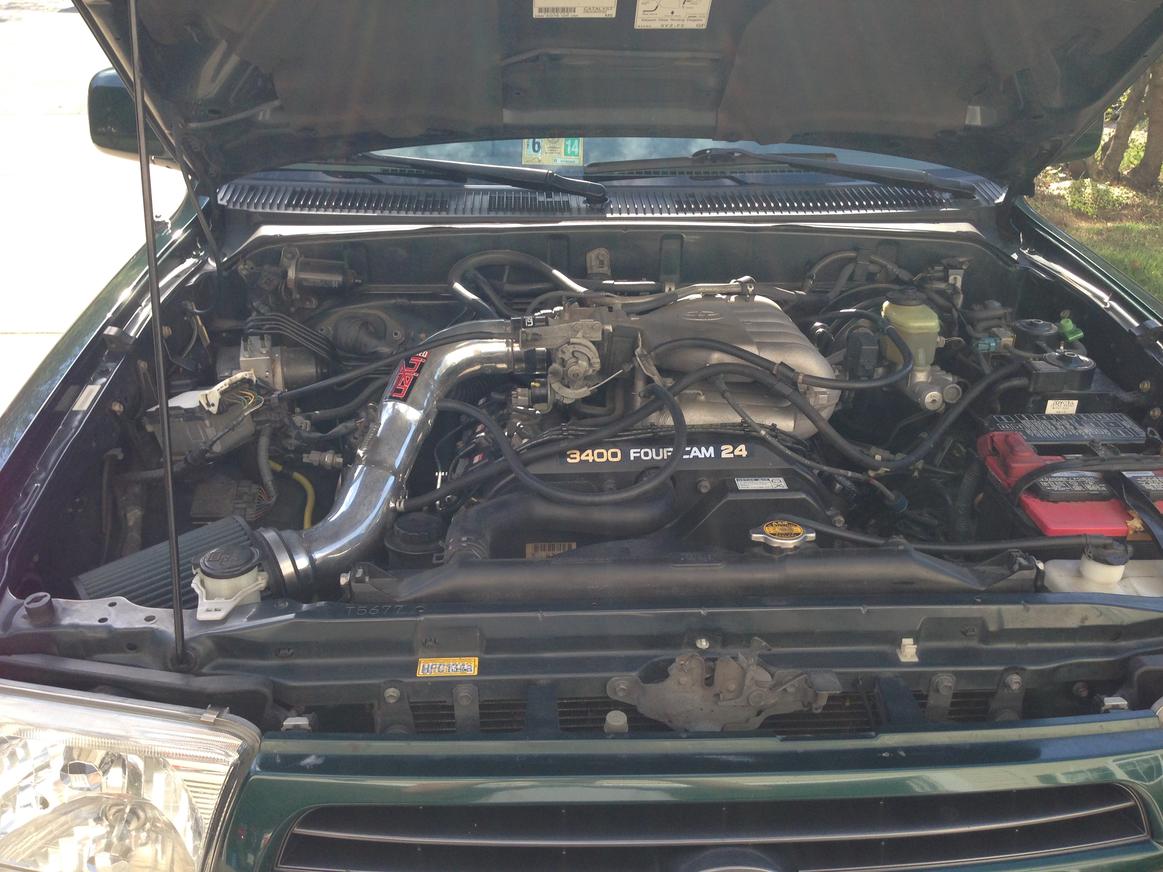

Inside the engine compartment, mostly maintenance
Previously installed INJEN cold air intake but had to clean it and while at it cleaned the MAF and throttle body.
Replaced the plugs with straight up Toyota Denso and wires.
Replaced the clutch master and slave cylinders as the fluid was almost black in the reservoir.
Something to not here is the replacement master cylinder I received was slightly different than the original. In particular the clevis pin was not as long as original so the adjustment range for the pushrod is shorter.
