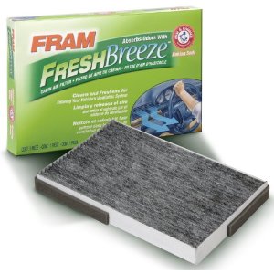

I just ordered Fram cabin filters packed with activated carbon and baking powder (CF9846A). I have 2 kids and mysterious odors in the 4Runner (combination of fermented juice box and little stinky feet). I will let you guys know how this product works. I bought it from Amazon.com for $12.71 piece. I ordered 2 and the shipping was free.
Here is the product discription:
The FRAM Fresh Breeze cabin air filter is an easy to install air filter that both filters and deodorizes the air drawn into your vehicle, as well as improves available airflow critical to the efficient workings of air conditioning and heating systems. Designed utilizing the first of its kind mix of active carbon and baking soda woven into the fibers of the filter, it has the ability to remove up to 98% of contaminants that drivers, passengers and vehicle air ducts are exposed to, while also providing twice the protection against commonly occurring odors than other cabin air filters.
Active carbon and baking soda in filter for better in-vehicle air quality and flow.
What is a Cabin Air Filter?
Not nearly as well-known as familiar oil and standard air filters, many drivers may never even have heard of a cabin air filter. Usually located either inside the passenger compartment near the glove compartment, or under the hood near the windshield, they are used to filter air drawn into your car from the outside for the comfort of passengers, as well as for use by air conditioning and heating systems. They are designed to minimize particles both large and small, as well as allergens and other contaminants and are used in approximately 80% of the vehicles built since the 2000 model year. It is recommended that they be replaced on either an annual basis, or every 15,000 miles. Like any other automotive filter, neglecting to do this can lead to possible risks to your vehicle and/or passengers, in this case including impeded performance of your heating or air conditioning systems by limiting the flow of fresh clean air used by those systems, as well as possible corrosion inside the system and musty or even noxious air vented throughout the vehicle.
Removes up to 98% of road dust, pollen and other contaminants, as well as most common odors. Unique Carbon/Baking Powder Technology
The FRAM Fresh Breeze Cabin Air Filter utilizes a unique technology that combines the natural filtering properties of activated carbon and the renowned deodorizing properties of Arm & Hammer baking soda. Infused together within the filter's folds this allows for the removal of 98% of road dust and road pollen* that your vehicle's air circulation system takes in. In addition, this combination also allows for superior protection against odors drawn from outside sources, providing twice the ability to deodorize common odors compared to filters not treated with carbon and baking soda.
Key Features
Premium Efficiency - Filters 98% of road dust and road pollen dramatically improving in-vehicle air quality*
Improved Air Flow - Periodic replacing of cabin air filters improves air intake air flow used in heating and air conditioning systems
Odor Absorption - The FRAM Fresh Breeze Cabin Air Filter packs twice the ability to deodorize common odors drawn from outside sources compared to filters not treated with carbon and baking soda
Fresh Essence - The FRAM Fresh Breeze Cabin Air Filter removes the reoccurring musty smell that can develop in air conditioning and heating systems
Easy to Install - Installs quickly and easily in most cars in minutes with minimal, or even no tools, depending on car model

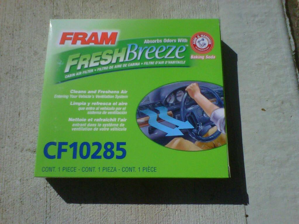

Sorry for the delayed post. As always, you guys were right. The CF9846A does not fit. I have ordered the CF10285.

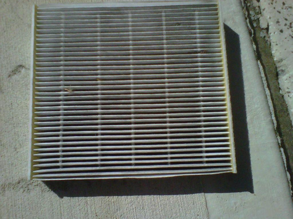

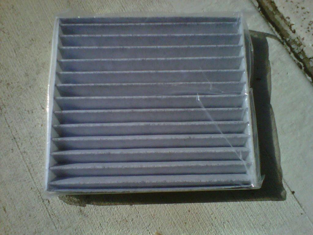

So the right filters came in and I immediately installed them in the 4Runner. It may have been my mind but I noticed a fresher scent coming out of the vents. The truck does not have the toddler / infant musty smell when I get in the truck. I noticed the Fram (see pic) has larger folds so it has less surface area to trap particles. I believe they did this to keep the airflow rate the same inspite of the carbon and baking soda sandwiched in the filter. I have not noticed any difference in airflow rates between the old and the new filters. My vehicle is 11 months old with 16k miles on it. The Toyota dealership "cleaned" my old filter at the 15K mile service. When I took it out, it had large particles lodged in between the folds and it was pretty dirty. I suggest you don't wait until 30K to change out your cabin filter. Overall, fairly pleased so far. The Fram filter was $18 and change. Not cheap but better than the dealership charging you $$$$ for a 2 minute job.
