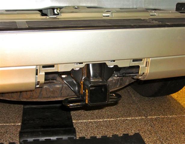

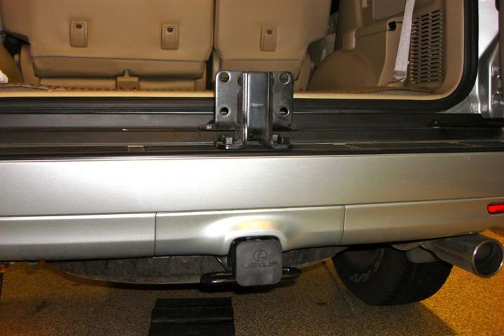

drnick and any others still wondering if the lexus frame mounted hitch will work, notwithstanding AlamoRunner's somewhat cryptic post,(see this thread, post #3), I am very confident the final answer is no. I have no idea about after market or maybe other model hitches, but this one, PT228-60100 won't go.

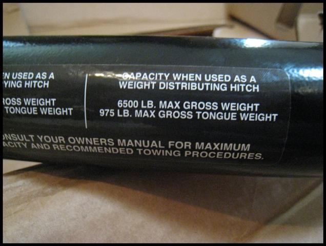

A couple of things I discovered in my research. First, even the Lexus Gx 460 has a trailer hitch like ours. It is called an "Intregal" hitch. They of course, had a choice. No hitch, Intregal or Frame mounted. Their Intregal hitch, same rating as ours, 5k and 500lb tongue ratings. If the vehicle did not have a hitch, but had the pre-towing option (I think), everything was there to install a hitch later, including a spacer plate/bracket that covered the mounting holes of the rear frame cross member, just like on our 4runners.

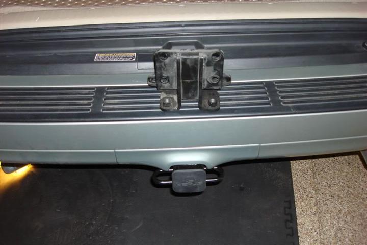

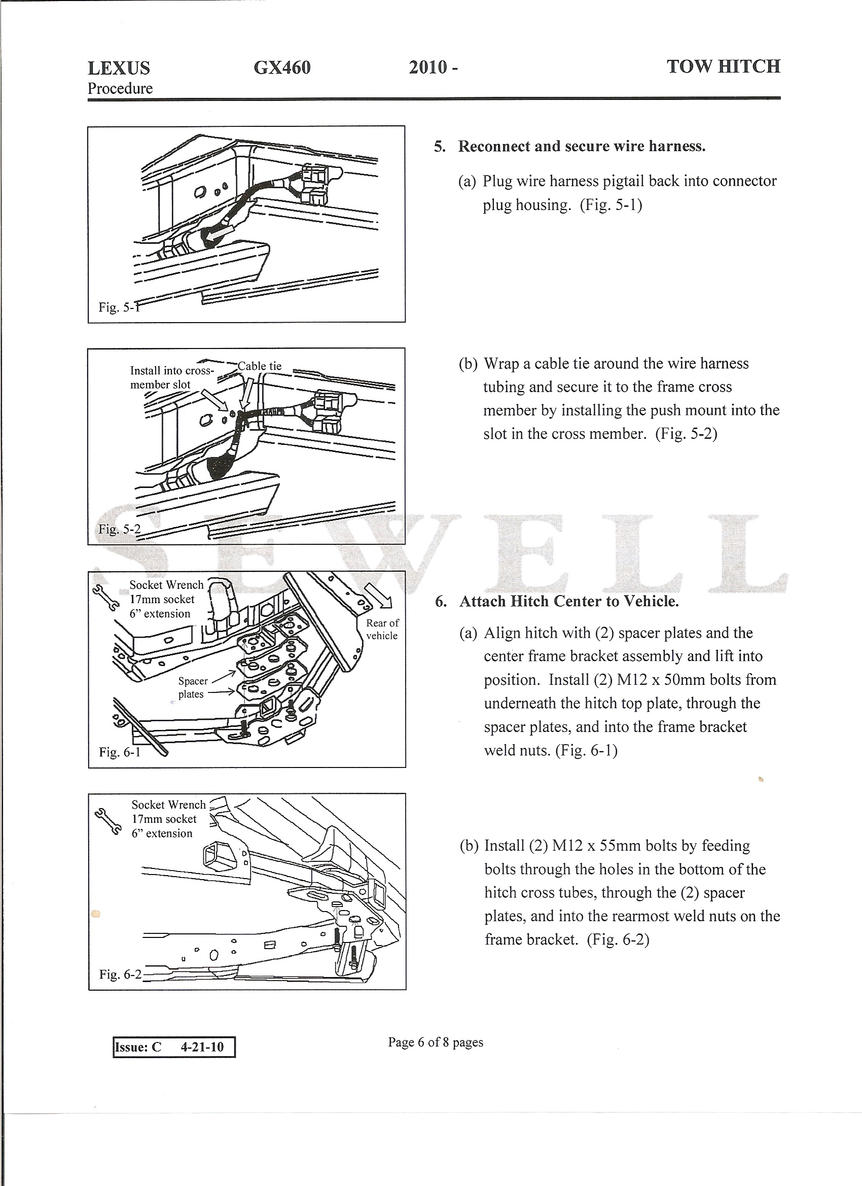

If installing the lesser hitch, you take that part off. (See Photos) If installing the full frame hitch, that plate/spacer or whatever is required. This is the part that I think AlamoRunner had trouble with at the bottom of his post, causing the whole project to fail.
Here is the photo of the Integral hitch for the Lexus. Notice the similarity?

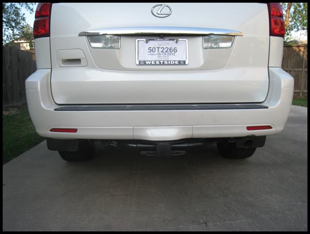

The 3rd and 4th photos shows that spacer/bracket or whatever you want to call it, removed. The 5th 6th and 7th photo shows the actual frame mounted hitch itself. I got these photos from Lexusclub.com and thier members made it very clear, if you had oversized tires and KDSS, this hitch mount WOULD NOT fit thier rigs. The last attachment is a page from the install PDF for the Lexus. Go to Figure or drawing 6-1. This is where I think AlamoRunner could not match up the hitch to the bracket and the cross member. Just a guess, but it fits his description of the problem. Be safe.

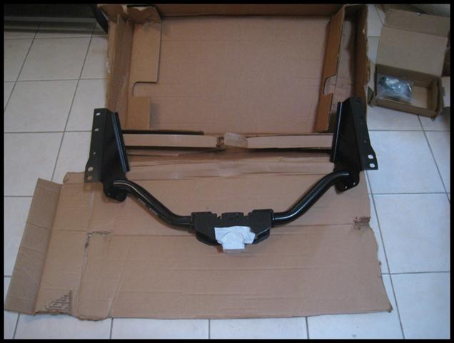

Apparently one of the photos did not make it in my post above, here it is. The photo of the Frame mounted hitch.

Jtraskell,Hmmm,those holes on the frame hitch look pretty similar to the holes in my 5th gen 4runner frame rails...other then having to remove the bumper fascia for install,and removal of the OEM hitch, I wonder???...why do you say it won't fit?? P.S. Alamo-runner's post,was somewhat confusing,but I thought he said it bolted on,and the spacer plate was rather confusing about install,but overall
I thought he's post said that the lexus hitch would work on the 5th gen 4runner??...I'm I reading his post wrong??
If I'm reading everyones posts correctly. The Lexus frame mount hitch attachs to the frame as well as the crossmember. And on the 4runner the cross member is closer to the axle than the Lexus, thus not allowing the mounts to line up at the crossmember. The frame lines up the crossmember does not.
If I'm reading everyones posts correctly. The Lexus frame mount hitch attach to the frame as well as the cross member. And on the 4runner the cross member is closer to the axle than the Lexus, thus not allowing the mounts to line up at the cross member. The frame lines up the cross member does not.
Yea, you are spot one. drnick, re-read the last couple of sentences of AlamoRunner's post. Then look at at the PDF page I posted above. What I got out of Alamo's post is that the frame mount did fit on the frame rails, but when it came time to bolt on the "center" of the hitch to the cross member between the frame rails (where our OEM hitch is already attached), it did not match. Do not know how to explain it any better then this. Just study what I have presented for awhile, it should become clear.

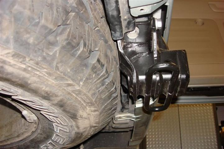

To hopefully clarify my earlier post, the GX frame mount hitch is installed and being used on my TE with only the side bolts (4 on each rail, 8 total). The center bracket/spacers/hitch is what does not line up on my vehicle. Could be OE difference between 4R and GX or could be deflection of crossmember on my from towing at max rating with a equalizing/sway control hitch.
During off-forum exchange with Leza he suggested welding the spacers in place thus linking the hitch/spacers/bracket all together and ending up with the original intent of bolting the items together. I will be getting this set up in the next couple of weeks since it will improve the integrity of what I have now which is already much improved over OE.
