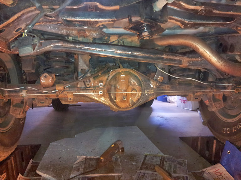

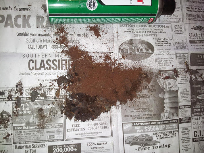

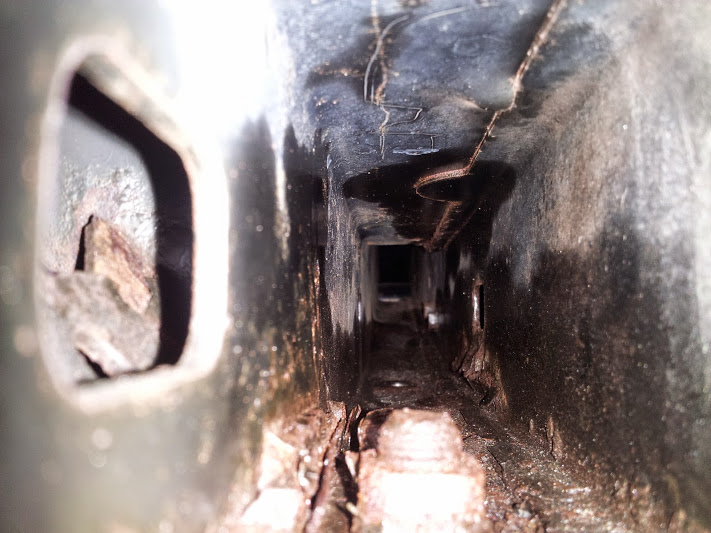

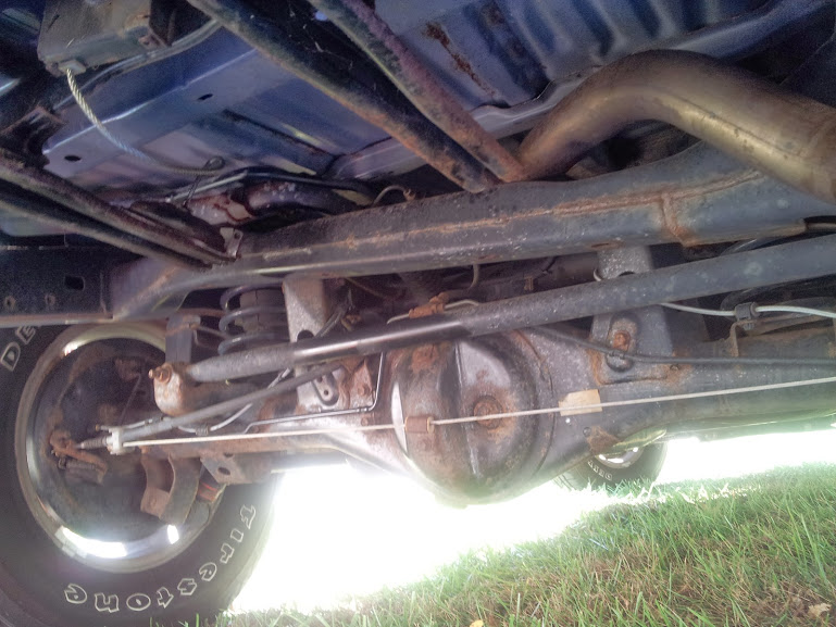

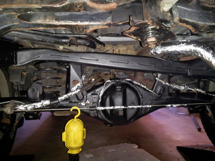

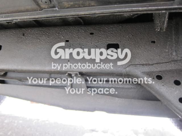

my rust removal project
Remind me of my rust removal project...such a pia and lot of work. I also used gallon of same paint with brush. Don't have all pictures but finished work looks much much better. Did whole frame..all skids..brackets..rear bumper...some area on body..etc..
Respirator is must for this job. I did lot of dust inhaling as I was doing it in winter inside my garage with small fan as exhaust fan...:frusty: I was using basic masks they are useless for this job. 2 broken bolts still need to be removed from frame.
