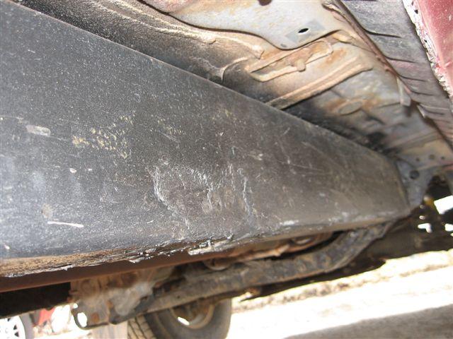

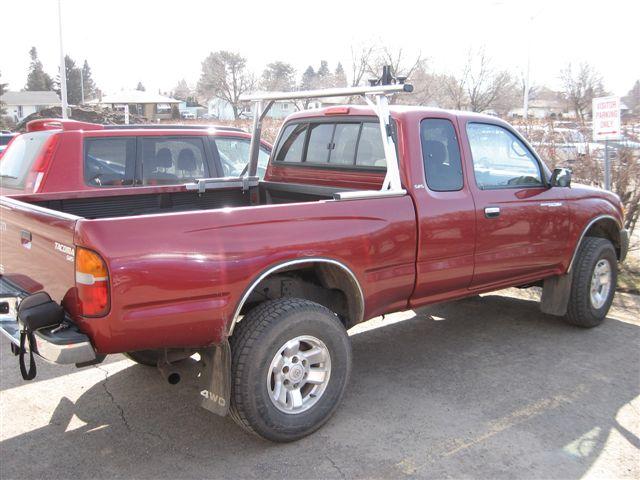

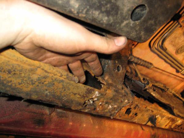

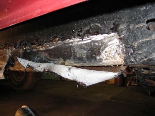

tacoma rust 99
frame
tacoma frame rust
http://s696.photobucket.com/albums/vv327/ksg807/
here are the rest of the photos.. crazy story when my brother bought a tacoma in Toronto. He drove it 1400 km after he bought it. Its amazing that it stayed togeter for the trip back home.
Whats even more crazy is that he bought it WITH a safety.. The dealer that sold it to him should be shot and pissed on. the frame had been sprayed with a heavy undercoating to cover up the rust. After he found out he sent the truck back to get fixed. I dont know what this dealer was thinking when he told him it was fixed by a professional frame guy. He used metal that was the thickness of a beer can. Thank god for forums like this one, otherwise he wouldnt have known
