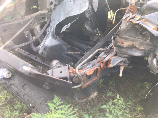

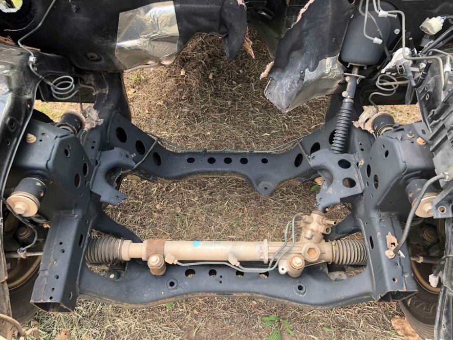

so need a little help on this frame rust issue i have. so i found this frame for $700 locally, but not sure if the impact it took can be repaired. wanted to swap this frame over to replace my rusty frame.
they looked at my truck and said that if i wanted they could cut the sections out that were rusted and replaced them with the good parts from this frame. Said they would sandblast the entire truck, put anti-corrision, and paint it so it would look good as new. total with the frame and the repairs would be around $1500.
what you guys think??

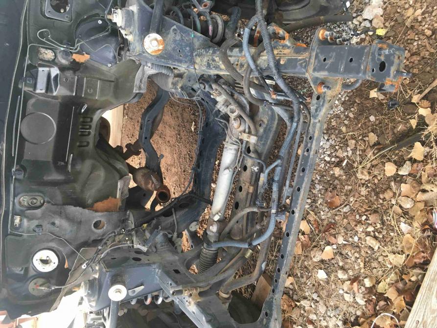

A few thoughts here in no particular order of importance.
1) That frame you're looking at took one hell of a hit. I'd want to take some serious measurements to determine how extensive the damage is before buying it. The undamaged parts of the frame look pretty good though.
2) As for cutting out the damaged section(s) of the new frame and welding in portions from your existing frame, that depends on how bad your current frame is. Cutting and welding on a frame can be very tricky. Done incorrectly, you can end up with one hell of a safety issue.
3) You say the total for the frame ($700) and the repairs would be $1500. If that total number is indeed correct, that's a hard pass for me because it's way too cheap. To do all of the work you mentioned correctly would be way more. For reference, a Tacoma frame swap costs a Toyota dealership just north of $10,000 including the new frame.

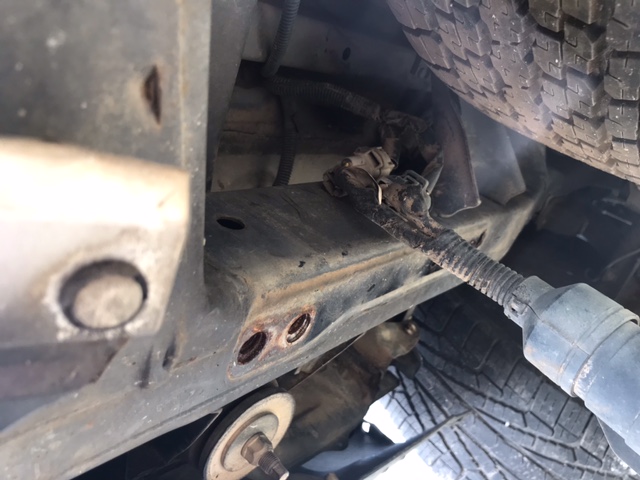

My frame is pretty bad, holes in various places. Hense why I took some pictures to get some opinions of this one. Rest of the frame looks pretty good besides the part where it took a hit from, that was my big concern, needs to be straightened or repaired not sure how that works.
As far as the cut and replace sections, I didn’t like that idea cause no telling what kind of condition inside of frame is like.
I don't think that amount of damage can be pulled back straight. If it can, I'd seriously doubt its strength in the event of another crash.

Yea thats tough. I'd be really nervous about that frame pictured in another crash.
Again, pictures may help us see what we think is fixable.

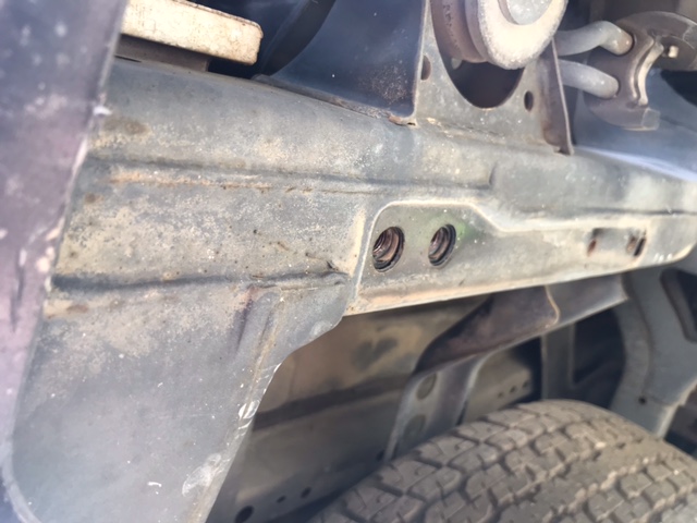

decent frame rust wise, impact was pretty severe... I believe it could be salvaged, but not for 1000 bucks to do what you're saying they will.
ya rust wise was pretty clean, the impact part was my only concern if a shop can fix that or not?? how can i find out locally if its fixable?? i've had zero luck finding a v8 chassis here in Florida. this was the first one i found.

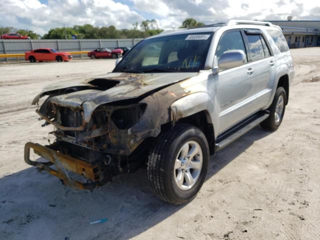

found this frame about 2 hours away, i called and not much detail on it, asked her if it was in a collison says she believes it only lit on fire. would this work for a frame swap??
