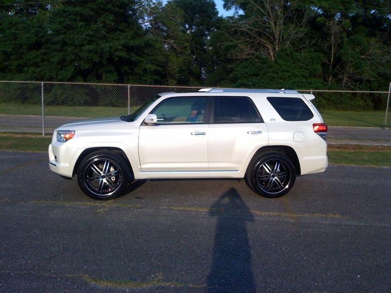

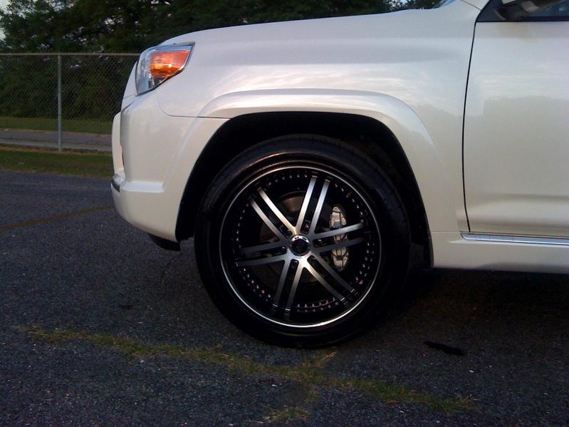

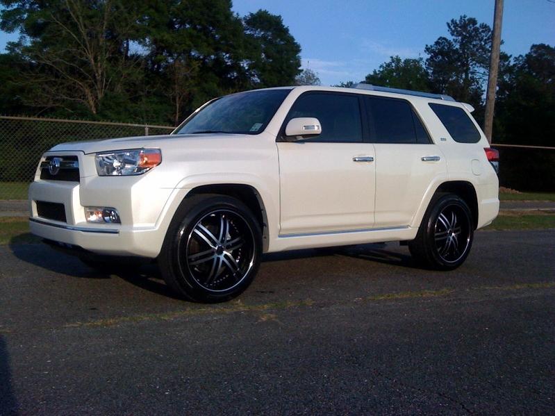

:guitar3:Finally got my wheels in and wanted to post pics! Have the stock SR5 wheels and tires posted in the classifieds for sale! Let me know what you think!

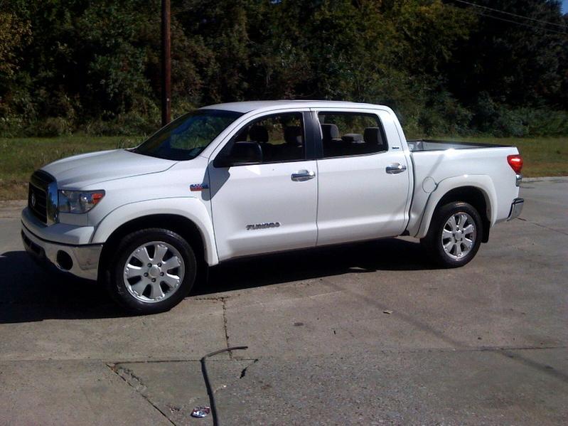

P.S. Had to post pics of my Tundra becaue he would feel left out and cry :crybaby:

I ordered the 22 inch wheels because it keeps my gas mileage the same! The tire is thes same diameter as the stock, 31.6 inches in height. This wheel is bigger the Limited wheels which are 20 inch.
Smart thing you did by keeping the rolling diameter the same, your speedo will read right. But, this doesn't necessarily mean your mpg's will stay the same. This will depend on the combined weight on the wheel+tire combined plus the width of the tire. If you bought quality wheels, the combined weight should give or take a few stay the same. However, some aftermarket big wheels weigh a ton (up to 60+lbs/wheel) increasing not only the total weight, but also the unsprung weight, which is more important. More unsprung weight will effect your handling and braking....
Just a few pointers. Have fun with your new truck...
I have been averageing 19.8 miles combined 70% highway 30% city. Engine only has 843 miles on it so hopefully this will increase! Since I have put the wheels on, my average per tank went up from 17.9 to 19.8. The engine must still be getting broke in since I have seen an improvement. Thanks for the info!
