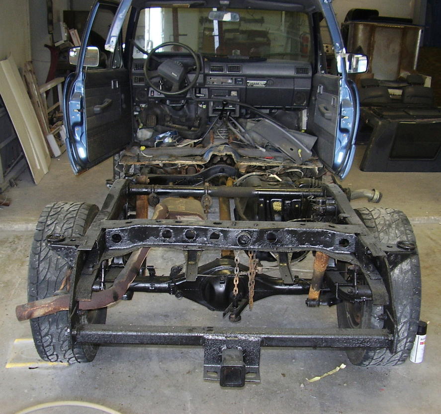

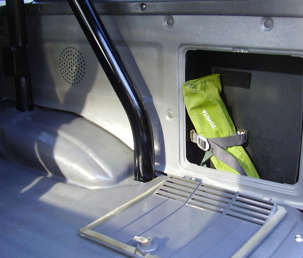

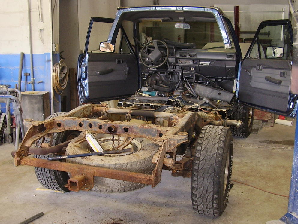

I have a shot of mine when the body was off. I also added a few shots of jack local, the long jack rod, and tool pouch.

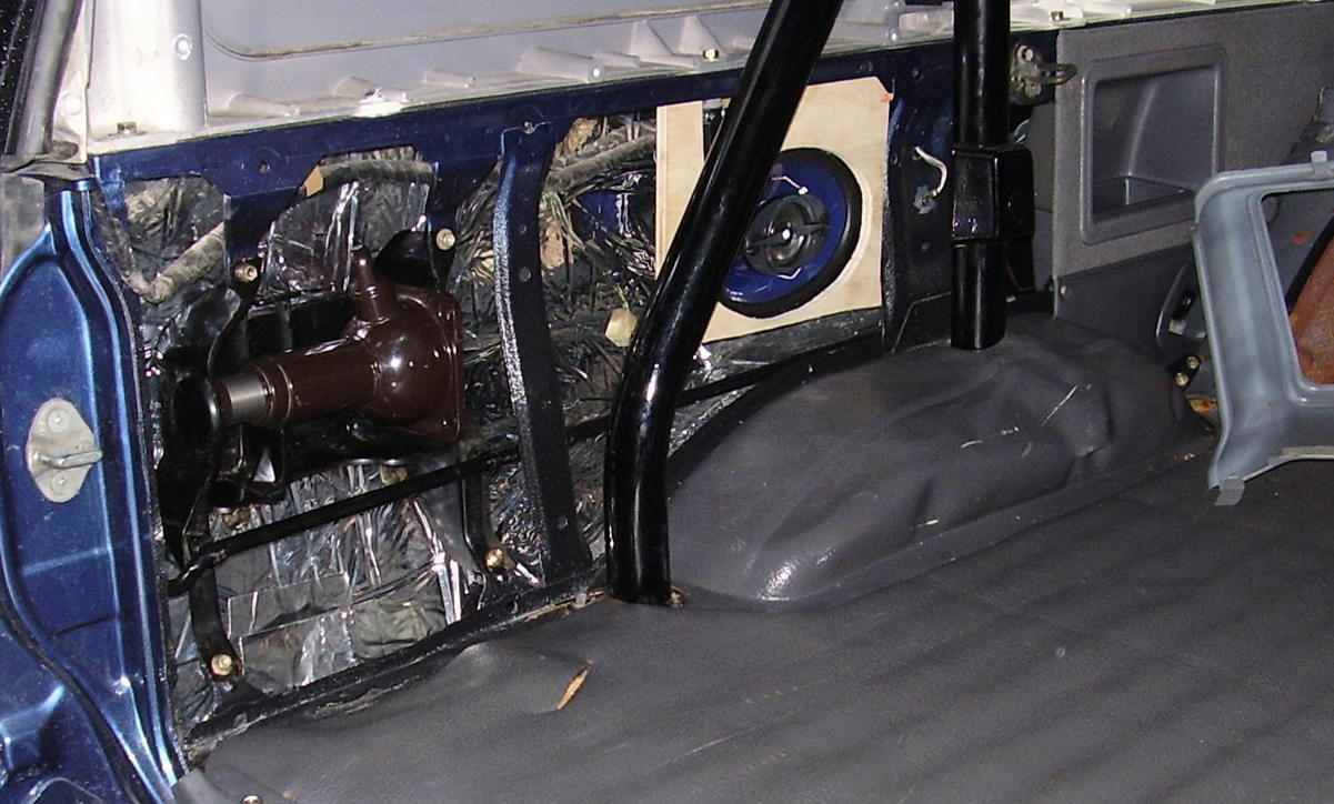

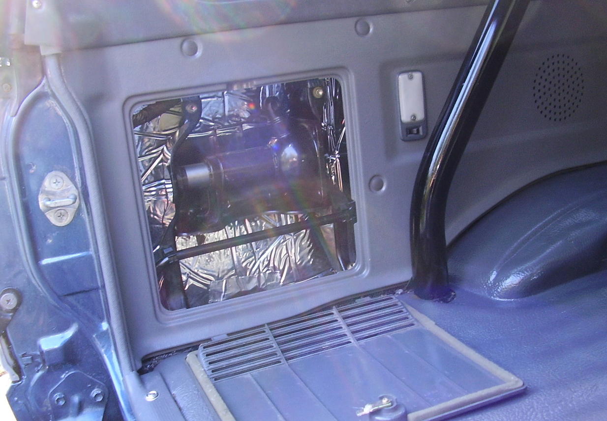

I restored all of the spair tire stuff, the tire fall, jack, and jack tools. Mine too was rusted solid..
