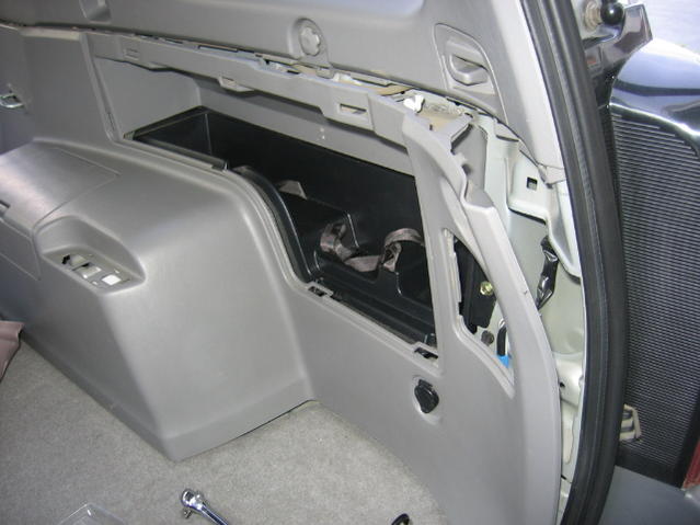

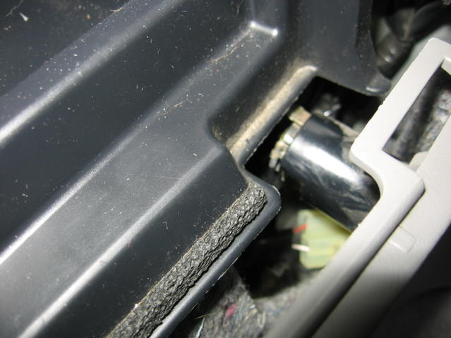

I had this problem right after the XM was installed. The guys didn't plug the wiring harness back in. It is kind of a pain to remove that panel but once it was off...plugged it back in and good to go.
Something to check if someone was messing around back there. Good Luck!
Could you tell me the location of that panel please?? Thanks.
It is the whole panel. In the right rear of the 4R that whole lower panel has to come off for you to be able to plug in the harness. You can remove just the part towards the rear of the truck to see if it is plugged in. Personally I found that it wasn't possible to plug in the harness without removing the panel. The harness is just short enough that you cannot get the length needed to just plug it in and go.

Shuly, I peeked into that panel and there are no wires connected to the 12V socket!
Took the panel off, reconnected the harness, and have 12 volts again!
