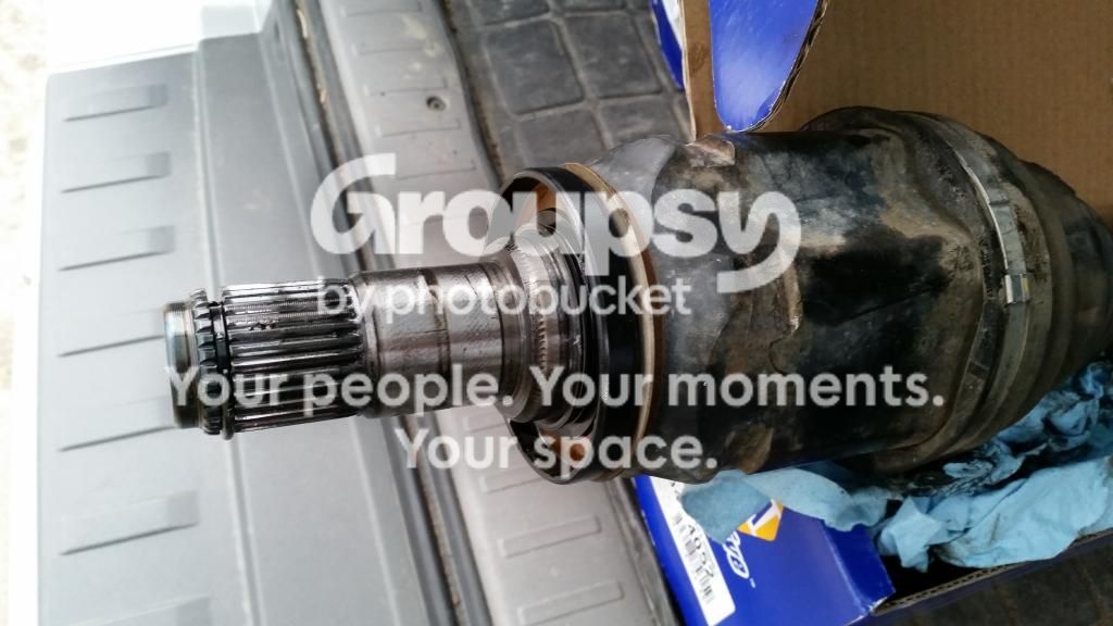

For some reason I found it best to install seal on the shaft and slide them together in place. I was installing seals first and then shaft and it always leaked by next day (new OEM seals, new shaft). Its really tricky to get it in right place, if you go too far you will crush the seal (what I had) and it will leak. It can also go in not straight and result in the leak also.
What I do is lube the shaft well and slide new seal in place just like shown on picture. All you have to do is just make sure your shaft going in straight until it clicks in place. It literally takes me 20 min per side swap the axles and that including taking my wheels off, I'm just like you using crappy NAPA axles with lifetime warranty and they always seems to fail around 2 year mark, so I'm their regular customer to get free replacements lol.
20140526_203541.jpg~original
