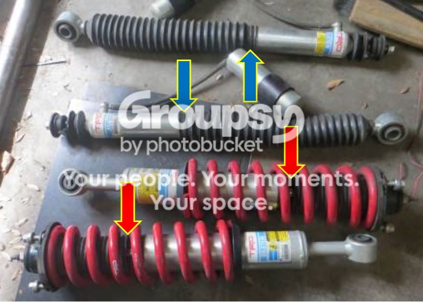

Can someone explain to me whether the boot on the strut is supposed to be loose on the bottom end of the boot where it meets the body of the strut?
I just picked up a used TRD pro suspension setup, the rear strut boot has a zip tie at the bottom, but it is not tight to the strut body. It easily slides up and down. See blue arrows in the picture.
For the front strut, there is a gap between the bottom of the boot to the body of the strut. See red arrows in picture. I tried pulling it down, but it does not want to stay mated to the strut body. Is this normal?

is there grease coming out? i ran into an issue with new blistein shocks and the moment the mechanic placed them it, it started leaking out. might be a bad shock
There aren't any grease coming out of it. It's looking like the gaps are normal. A friend of mine just bought brand new suspension assembly it and it has the same area where the metal shaft is exposed. Once it get installed and the spring compressed, the metal shaft should no longer be exposed. I was just concerned about a situation where your tires are off the ground and the suspension is fully extended where the metal shaft would be exposed.

In my experience the boot is to be zip tied to the body of the shock to prevent debris from getting in there. i would pull the boot down, if able, and zip tie it against the body of the shock. May be worth a little gorilla tape to hold it in place if it keeps sliding off. If you run it without a boot it will void Bilsteins warranty.
If you go mudding allot then you may want to keep it loose so you can pull it up and rinse it out. Be sure to periodically clean it out if you keep them loose.
Keeping it clean is a good key to keeping them working well and not leaking.
