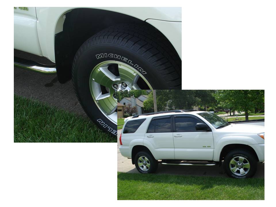

The Michelin LTX/MS2's are nice and quiet, I think I'll be happy with this choice. I am not happy that the huge balancing weights from the Dunflops left marks on my rims :-)
