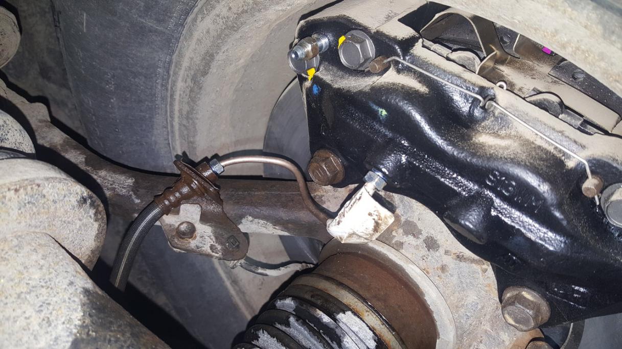

I always use OEM brake lines as they are not that expensive in the USA. I mostly paint the new brakes lines with rust-oleum. However, I have used the little copper nickel lines from Napa {shortest ones they had for Japanese vehicles 3/16 }as I was changing brakes and the piston pushed out too far damaging the caliper. So being I needed to get this back in the road fast. I couldn't wait for the OEM lines. Both Front calipers where changed on Tetanus 1 with re-mfg calipers. As the originals with 250K and 21 years needed to be replaced anyways. {Salt had them pretty oxidized} The Braking did improve when the new calipers went on along with Rotors and New Pads. :D
