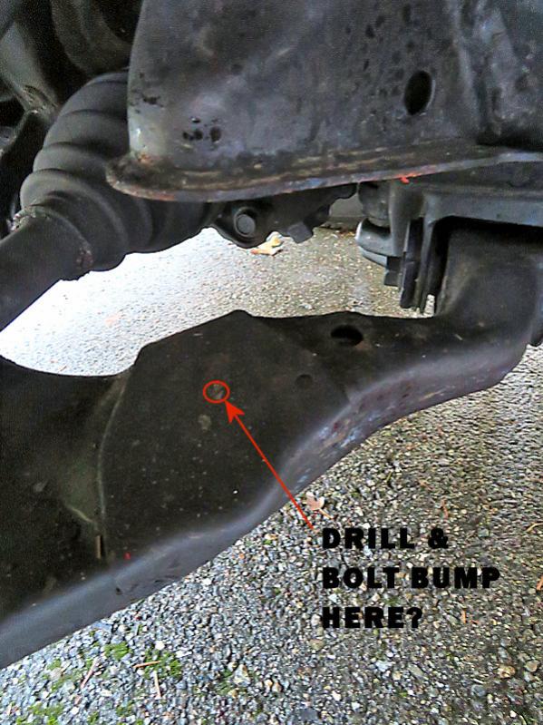

Well, today this rookie broke off a front bump stop bolt. The break occurred just inside the bolt well, without a sharp bolt edge sticking out. In other words, the old mounting plate is flush.
So my question is this:
Can the new bump stop be relocated to the original bump stop plate on the LCA, by drilling a new hole, threading it, and Loctiting it, so that the bump stop is aligned to hit against its prior bracket location? (I've mocked up the proposed new mounting point in the image below.)
If so, this would allow easier access to the front bump stops if changing them out later, as well as saving time trying to get the old bolt out.
What are your thoughts and concerns here?
Much obliged for your input!

Montijo: Thanks. I saw that thread from back in November, where rivnuts were discussed. But there wasn't a conclusion/solution at the end of it, other than the drilling and extraction that most threads on the subject entail.
Still, I'm curious about the location question, not having a lot of mechanical experience. Why are the bump stops mounted above and not on the LCA? Is it a matter of concern over tearing them off while offroading? Or maybe a matter of LCA integrity (although it has other holes)? Doesn't look like that location would impact the function of other hardware or lines under there. All thoughts on this welcome!

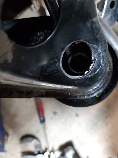

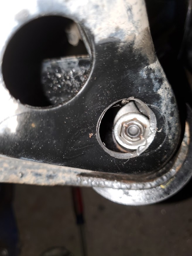

sorry, I'm late to the party. Spent few hours recovering a 3rd gen from the edge of a cliff yesterday and got home wiped out.
As was explained, I drilled a hole directly on top of where the broken bolt lives using a step bit. Once the hole was big enough, I used a pry bar to work the captive nut (with four sides) from its location. The captive nuts in our vehicles are usually spot welded on four sides so they're easy to knock lose with perseverance.
The last pic shows the placement of a socket.

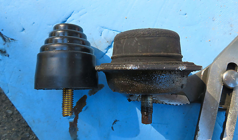

After breakin' off the driver side front bump stop bolt, the passenger side came out intact and fairly easy with PB Blaster and judicious elbow grease on the pipe wrench (see pic below). However, with the new Energy Suspension bump stop, there's no integral metal base plate on which to use a wrench to tighten it in. Just a bolt in the bottom of the rubber. Turning by hand, the new bolt would only make it halfway into the bracket before stopping. An attempt to turn it with channel locks felt pretty dicey - like I'd loosen the bolt within the new bump. Instead, I JB Welded a stack of leftover washers together to create a redneck spacer, applied liberal Loctite to the bolt threads, and tightened it in by hand (see image below). We'll see how she holds up. :rolleyes:

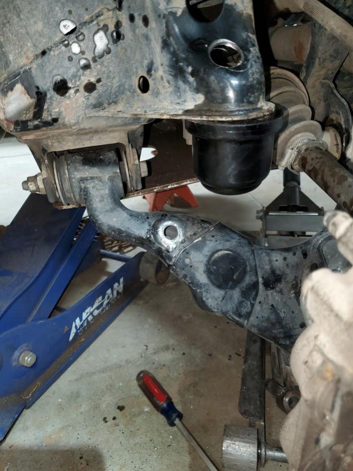

I'm trying to remember how far the LCA will swing down without much extra effort haha. To get it to swing lower, you would definitely need to remove the two 19mm ball joint bracket bolts and the 19mm on the lower shock mount. Mine is pretty crusty, not sure how much yours is, and I had no problem with any of these bolts. Thankfully they're nice and chunky. From there, it should come down further, but may have to press against bushings wanting to come up. Shouldn't really be a problem for a quick drill I think
This is mine with one side of one cam cut out and how far I had it down. Hopefully this will give you an idea of about how far it will come down when unbolted from spindle
That's a real helpful picture. Thanks, Y. That much droop should be just enough to allow the bit to enter the bolt vertically. Then it's just steppin' up the bit size incrementally. Good deal! :thumb:

No problem, I've got a zillion pictures for all my projects for this reason haha. I'm not the greatest explainer, but pics the tell a lot!
FWIW, when I recently did my suspension, removing the lower shock bolt and the 2 19mm around the lower ball joint allowed me to get that LCA almost perfectly vertical - so plenty of space.
