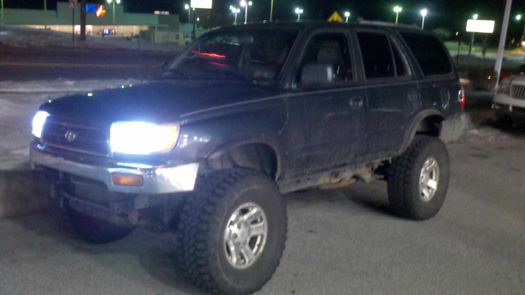

I just picked up a 97 4Runner SR5. It has a body lift and 35s. The front chrome bumper is up attached to the body, and the bumper mounts on the frame are sticking out with the radiator exposed. I need to get it inspected, and I am sure in MD they will fail it, because there is nothing attached to where the bumper is supposed to be. If I take the chrome piece off and try to attach it to the bolt holes, I am not sure, but there may be some rubbing. I'd like to find a way to get it through inspection. If I drop the chrome piece down and it doesn't rub, then I have the middle gap area showing. I was told it's a 5.5" lift, but I highly doubt it's all body lift. Is there a bumper I can get somewhat rather quickly, without spending a grand? I looked at ARB, but they are so expensive. And whatever I get, I would need it to bolt on the the holes on the frame up front where the bumper is supposed to be. I hope I can just bolt something on and left the chrome bumper as it is, so I don't have to worry about the running lights. Thoughts?

Ok here is a pic. Hopefully this clarifies it a bit.

Im pretty sure that your bumper is bolted to the correct location. It does not bolt to the end of the frame rails.
You are missing the plastic bumper valence that would cover up the frame rails, even with a small body lift, but in your case it looks like you have a 3" bl ( i can oddly see the entire frame down the side of your truck) and thats probably why the po took it off.
My best advice it to go and remove the body lift. Its not that hard to install one so it shouldnt be that hard to remove. Just if you do remeber to take the steering extension out and the radiatior drop brackets

JMoney said it. The chrome bumper looks right or at least close.
The frame ends didn't have anything on them till 99 or 2000. Then they added a steel cross member that was hidden behind the plastic below the chrome (your plastic is gone)
If you are concerned, you could do a simple rectangular tube thru bolted to the frame ends. It could be pretty simple.

yeah, your bumper is in the correct location in relation to the rest of the your car but its definitely not in the factory location in relation to your chassis. Your chrome bumper actually is supposed to be right infront of the red circles I drew. Essentially the blue circles should eclipse the red circles for the bumper to be in the factory location. Ergo, you definitely have a body lift :)
