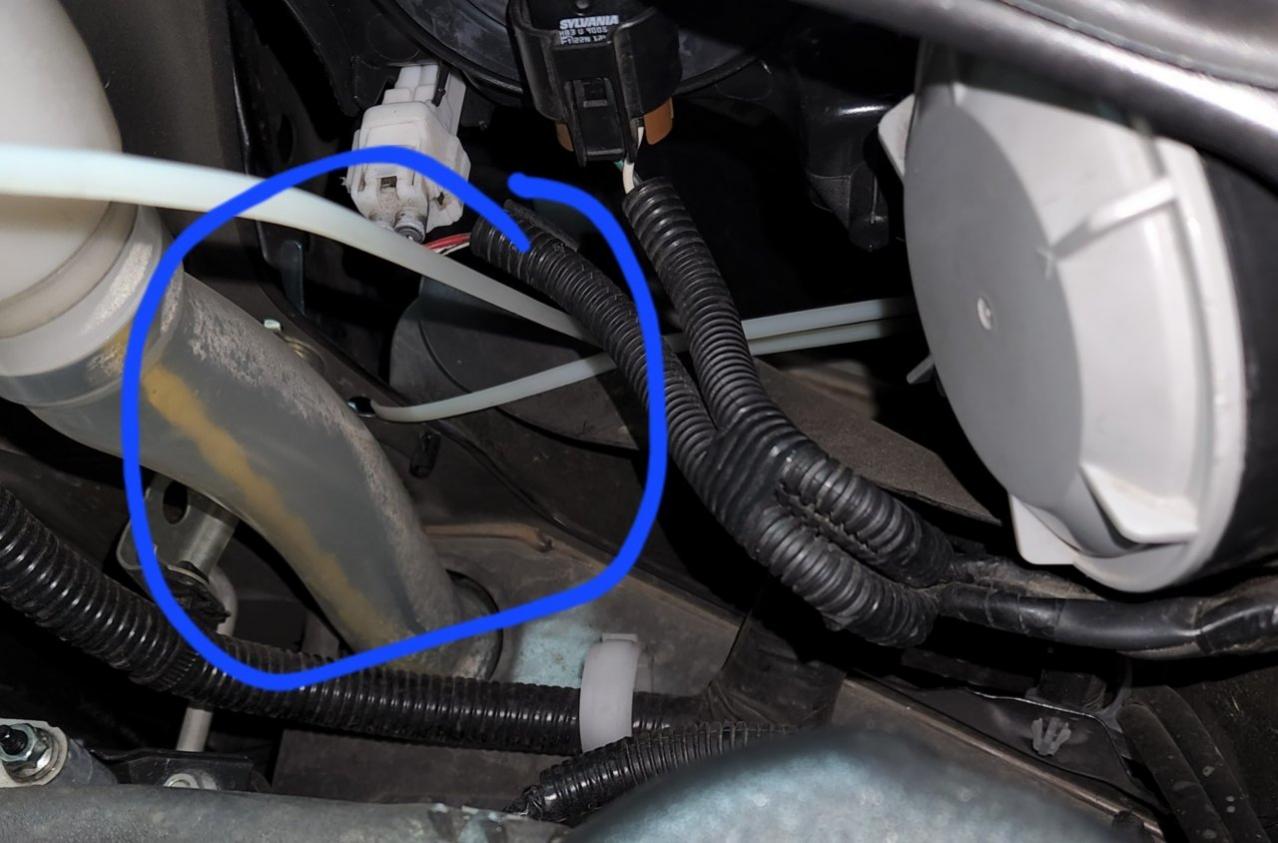

All of that said, I was not impressed with the TSB. Does it capture the portion of the bumper cover under the headlight? Yes it does. But, the stack up of the Velcro causes the sides to bulge out. After about two weeks of looking at the mess, I ended up pulling the cover off again, and used the smaller attachment points (circled in green) at the top of the bracket and removed the larger Velcro pads below. It works and looks better for me, YMMV.
As previously stated, the whole thing is kind of half a$$. If I were doing this again (before spending $100+ on brackets, Velcro, etc.) I'd try to find high end waterproof two way tape (something like 3M VHB) and use with the existing brackets, applying the tape in the area circled in yellow. I have a suspicion, if you use the adhesion promoter with the two-way tape in this area, the problem might be solved without the modified brackets. Again, YMMV.

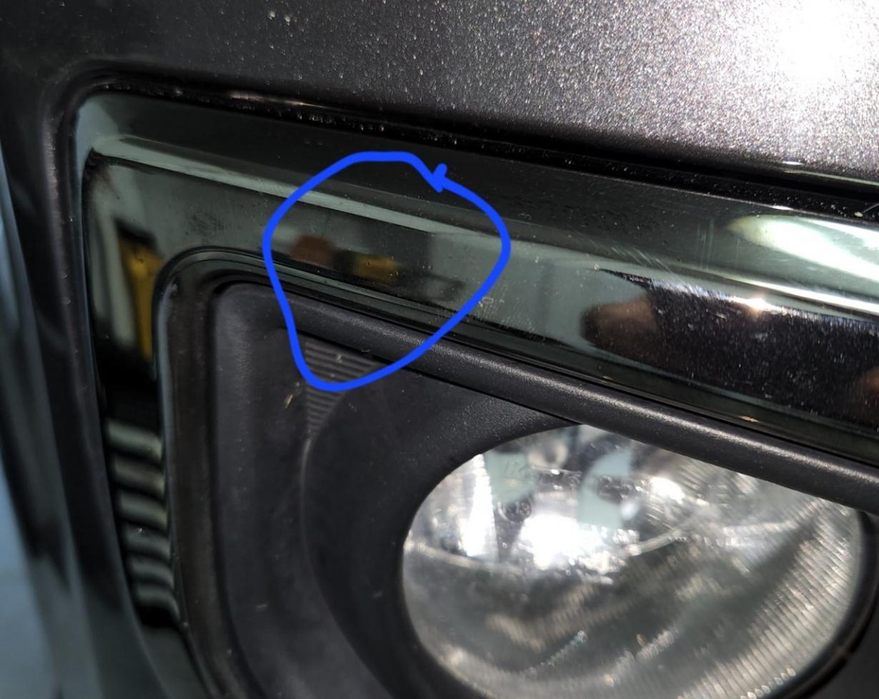

I pushed where it is locked in under the headlight, and I saw the outer side where its popping out move.

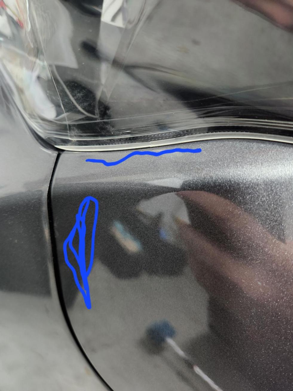

Someone posted somewhere in the forums, that maybe the fender area needs to be pulled out a little. If you look in post 5, there is a pic of the fender, with bumper gone. The wavy section of the fender hidden by the bumper may need to be pulled out. If you look at this other picture I just took, the drivers side is in a little and tucked under the headlight just also a bit, I think. Need to look at other 4runners.
But, its a thought as the passenger side of mine was pushed in a bit, and I can see it. I need to see if I can pull it out a bit.
This pic shows how the fender is in further than the bumper, and under the headlight where the little blue lines are, its a but tucked under.

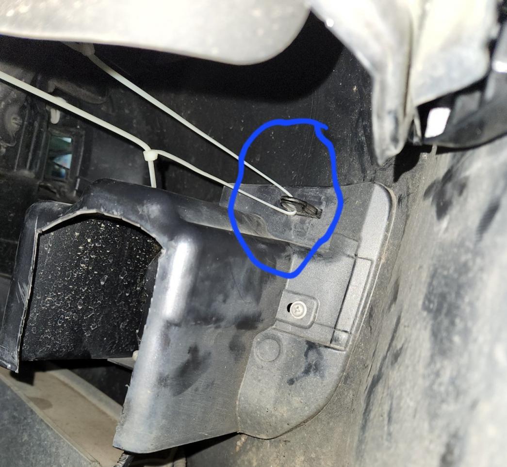

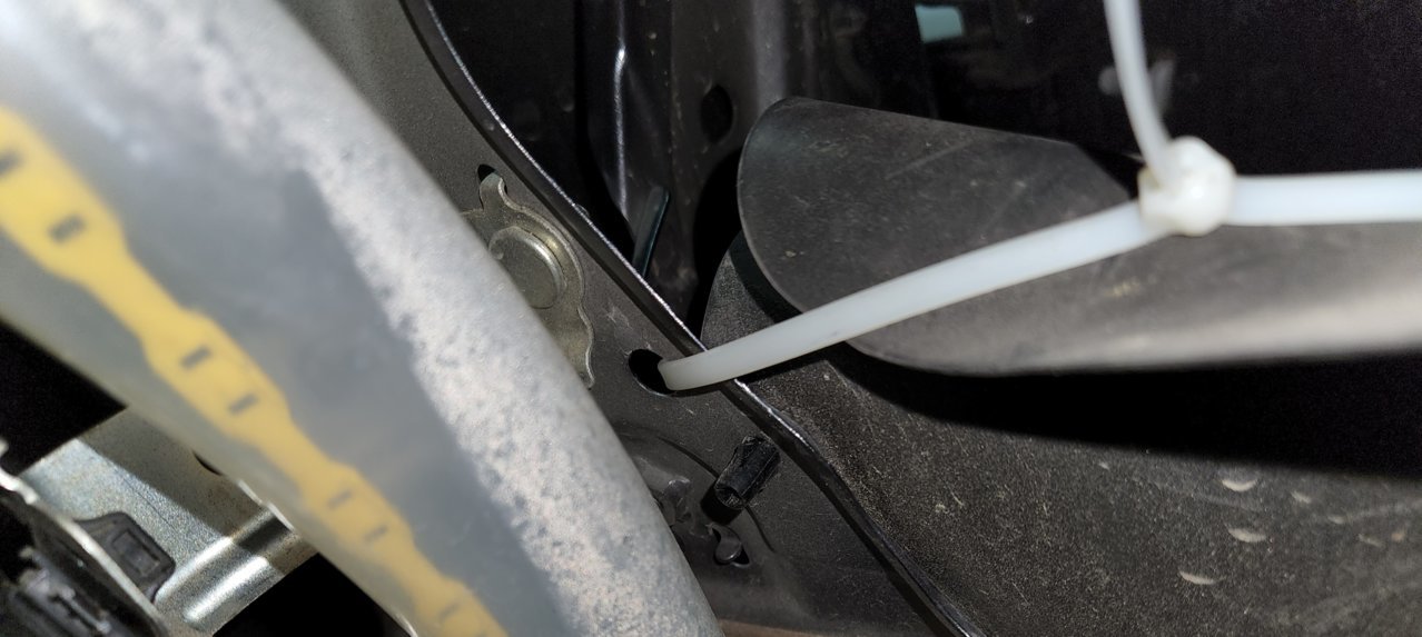

Bumper came off before I even went down the street. Velcro did not work.
I either need a new bumper or it needs to be super epoxied on.. What a POS.
Well, went a little redneck on it and fixed it, well made it stay till I can honestly evaluate the fix. Probably a new bumper and such.

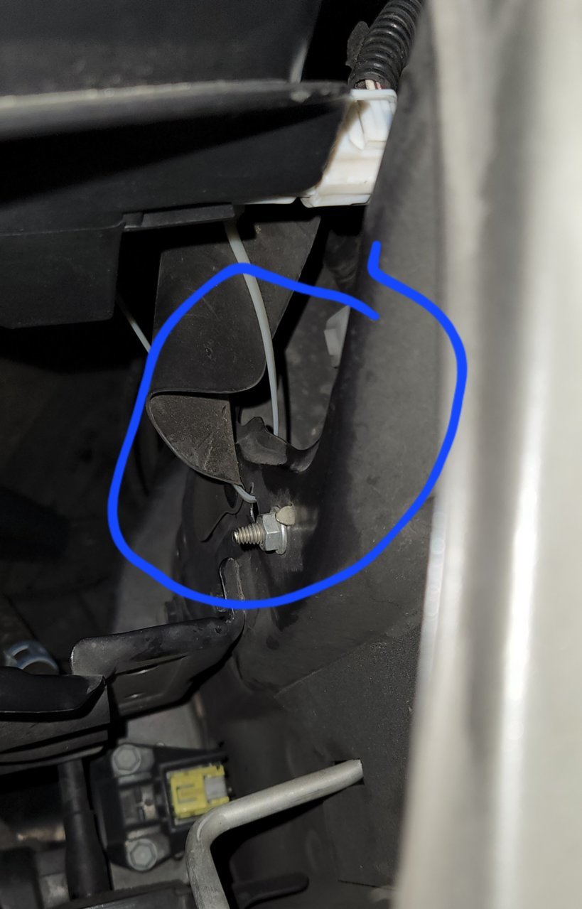

I went and put a temporary zip tie into a bracket near the windshield washer fluid. Its a metal one. And, the other end of the zip tie went into the bumper, chrome section of the limited, that attached to the cover. I took its clip out and ran the zip tie through it. Then, lightly pushed on bumper cover and sinched the zip tie.
Then went on a very bumpy ride for 20 plus miles. Bumper stayed..
Its a temp fix, but it is holding so far.
I am fairly certain the passenger side fender front needs to be bent out a little after it was hit and it will allow the bumper to hold in place.

Just an update, after 6 months , bumper has not moved. Zip ties seem to be working for my limited, to keep bumper in position it came from the factory.
