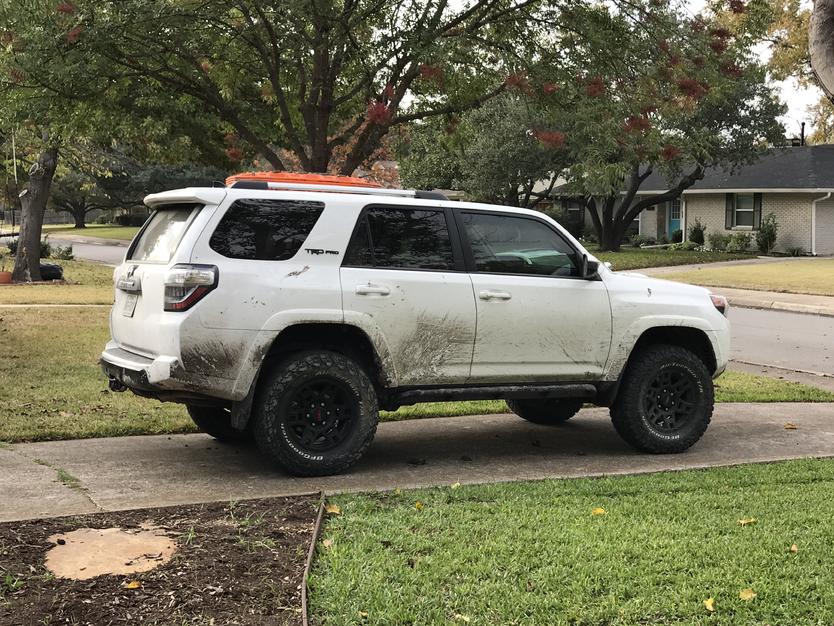

As for the weight up front, that’s why i was curious about the aluminum. I hate the idea of having rake. I was thinking about installing the Toytec 2” trd pro lift, do you know if that would prevent the rake at all? Or would I have to do a full suspension swap?
To answer your question on the rake with that toytec lift, I’ve got it on mine and it still has some rake. It’s lifts it 2” both front and rear. I’ll try to attach a picture to this post of mine so you can see it from the side.
Also, these guys are right about the bumper instead of bull bar. Aluminum is still really strong, I bash my aluminum skid plate quite often and it doesn’t have any damage on it so far, but that’s not quite the same force as hitting that heavy of an object that fast either.
