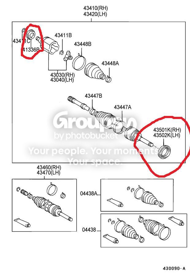

So I think I found the 2 seals were the axles go into the diff. But i cant find the other 2 that face the wheel bearing.
From looking at the pics its either the dust seal, dust cover, or front wheel seal . But im not sure.

I'm on mobile view so I can't post the diagram till I get home later. But I'm replacing my axles and there's a seal at each end of the axle. On in the diff and one at the other end of the axle which keeps dirt Out of the wheel bearing...

heres a pic of where the 2 seals go.
axlewithmarks.jpg~original
Just to update the thread in case anyone else is ever looking for the part number, the two seals for inner side of the axle are.
Toyota 9031147013 1 $ 11.88
Toyota 9031147012 1 $ 7.15
I ended up reusing my outer seals
