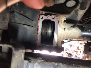

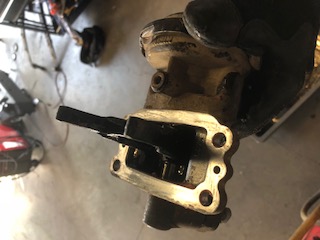

You can take the actuator off easily without removing the diff. Pictures attached, just 4 bolts and some FIPG.
Good luck!
Good luck!
thanks, I might look into a new one from arayama and just swap it out, its 18 years old might be all gummed up or something
