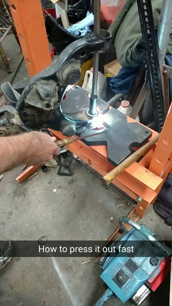

So I tracked it down to the LCA bushings. I've read its a PITA to replace them. Have anybody tried aftermarket LCAs? They're pretty cheap and come with new bushings. I'm not going to replace it myself so I'm just wondering if the labour for replacing the bushings is going to be cheaper than swapping control arms and just paying for the parts.
It is very much a pita to do.. I had to burn the rubber out heat up the inner sleeve and hit out with a chisel.. If I didn't have friends with tools I would of bought OEM LCA. If you need to find bushings look up white line bushings
