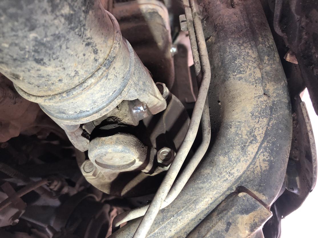

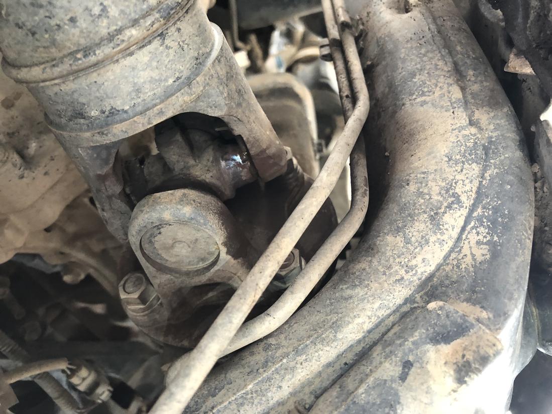

We’re in the middle of our trip and have gone about 2500 miles. We started getting a really bad vibration above 40ish. I checked and the front CV has failed and is almost twisted out. We decided to cut the trip short and head home but I need to either disconnect the drive shaft or go slow home and hope it doesnt catastrophically fail and ruin everything around the drive shaft.
My big question is will it ruin the center diff if I disconnect the drive shaft? Will it hurt anything to drive with the front shaft disconnected. Is either side a slip yoke or is it just the flanges like it looks like.
We have about 400 miles to get home left and we’re also pulling about a 3500 lb trailer. We’re in a Walmart parking lot tonight so I need to decide what I’m going to do to get home.

Seems to me by what I see in your picture, you have a bad Universal joint on your drive line.
Pull the drive shaft out, and replace it.
Just put match marks on the drive line and slip yoke in case it slide out before removal.

I think this is where some confusion is. The pics show a toasted ujoint but he mentions a cv in the OP. Either way I'd Just pull it and fix it too.
I meant U joint not cure why I wrote CV. I pulled the drive shaft though and I’m just gonna run it home without it. I’m in a parking lot in the middle of no where so hammering out the old joint and pressing a new one in would be a pain. I can do the work at home no problem but I’m still 400 miles out that’s why I’m asking
