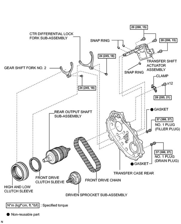

Refer to post #46 on page 4 for more info. Basically it was my Transfer case causing the issue. I started working on it on Monday and finished up Saturday night. I was super lazy!
Monday was removing the rear drive shaft
Tuesday was the front drive shaft
Wednesday was dropping the T case
Thursday was splitting the old T case and pulling the actuator off and putting in the new seals(what a pain)
Friday I split my "new" T case to install my old actuator and prayed for a miracle! I pulled the entire actuator apart and used a paint pen to mark the gears for timing then had to move the gears to line up where the rods were (it looked like my new Tcase was in 4lo and my old Tcase was in 4hi) so the marks I made basically did nothing. I have no idea how it is actually working the only word that comes to mind is miraculous!
Saturday was FIGHT NIGHT! I had to wind up using brute strength to get the T case back in because my jack wasn't working. It was fun I even had my dad crawl under the car to twist the rear driveshaft flange and line up the splines on the tranny output shaft.
Sunday I bought T case fluid and a new battery and she fired right up after sitting for an entire year! The satisfaction of fixing a problem I was dreading for an entire year is hard to describe. Now it's time to fix that drooping front end.

I just realized that when I had my driveshaft off I wiggled the rear output shaft and it made quite a bit of noise also the transfer case is soaked in fluid. It looks like it leaks or leaked all the fluid out. Is it just like my rear end? Bottom is for drain plug top is for fill and fill until it overflows out the top plug?
On the transfer case there are only two plugs. Drain and fill. The leak isn't coming from either though. If it's leaking fluid it's from one of the seals or from where the 4x4 actuator connects.
