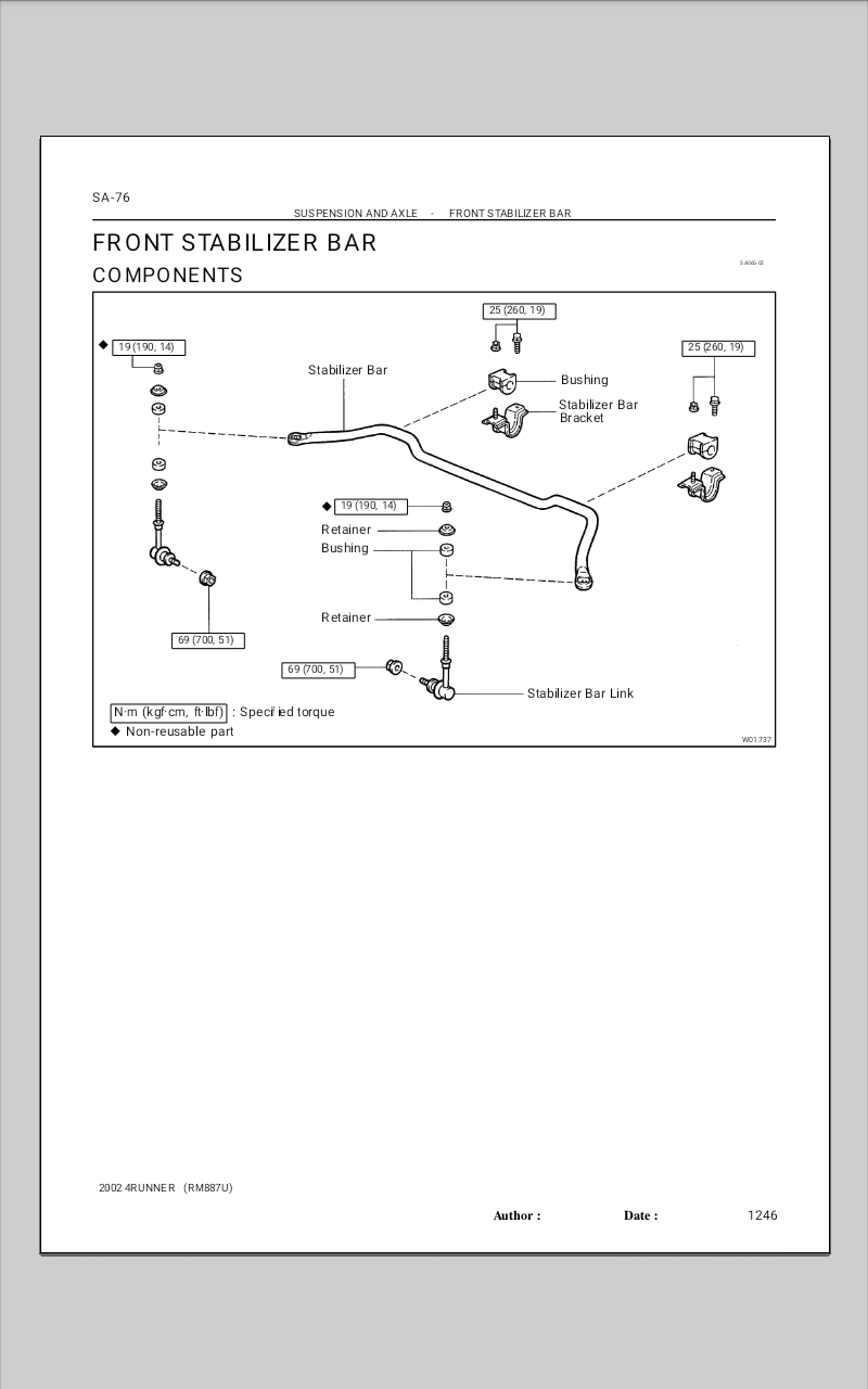

Sway bar is refered to as stabilizer bar and sway bar links are stabilizer bar links.
