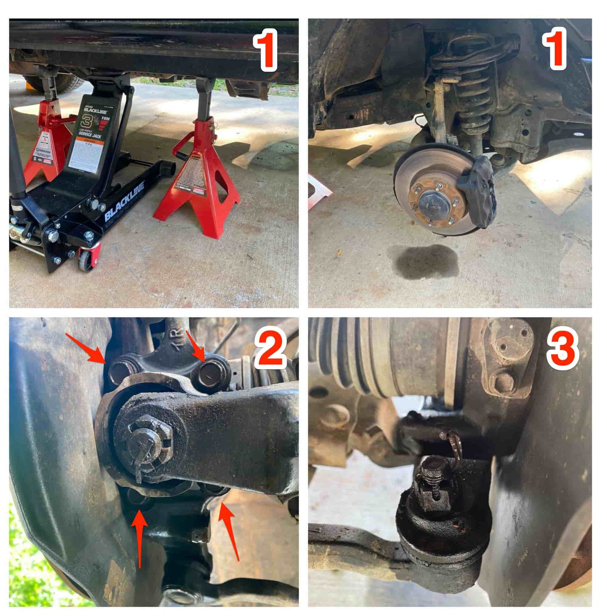

Removing the Front Tire
1) Jack up one side of the vehicle in a designated jack spot until the front tire is off the ground. Using the jack stands, secure the truck so you're able to remove the tire and work under the truck. Use chock blocks on the rear tires to ensure the vehicle does not roll out while you're working on it. Using a 21mm socket remove the lug nuts. Might need to use a breaker bar to loosen them. Remove the tire once all lug nuts are removed.
Removing The Old Lower Ball Joint
2) Loosen the four LBJ bolts with a 14mm socket and ratchet or breaker bar if they are stubborn. Do not take off the bolts, just loosen them.
3) Remove the cotter pin from the outer tie rod end and using a 19mm socket, remove the castle nut. Place the castle nut "up-side-down" on the outer tie rod so when you release the outer tie rod from the wheel knuckle it won't be so aggressive when using the Pitman arm.

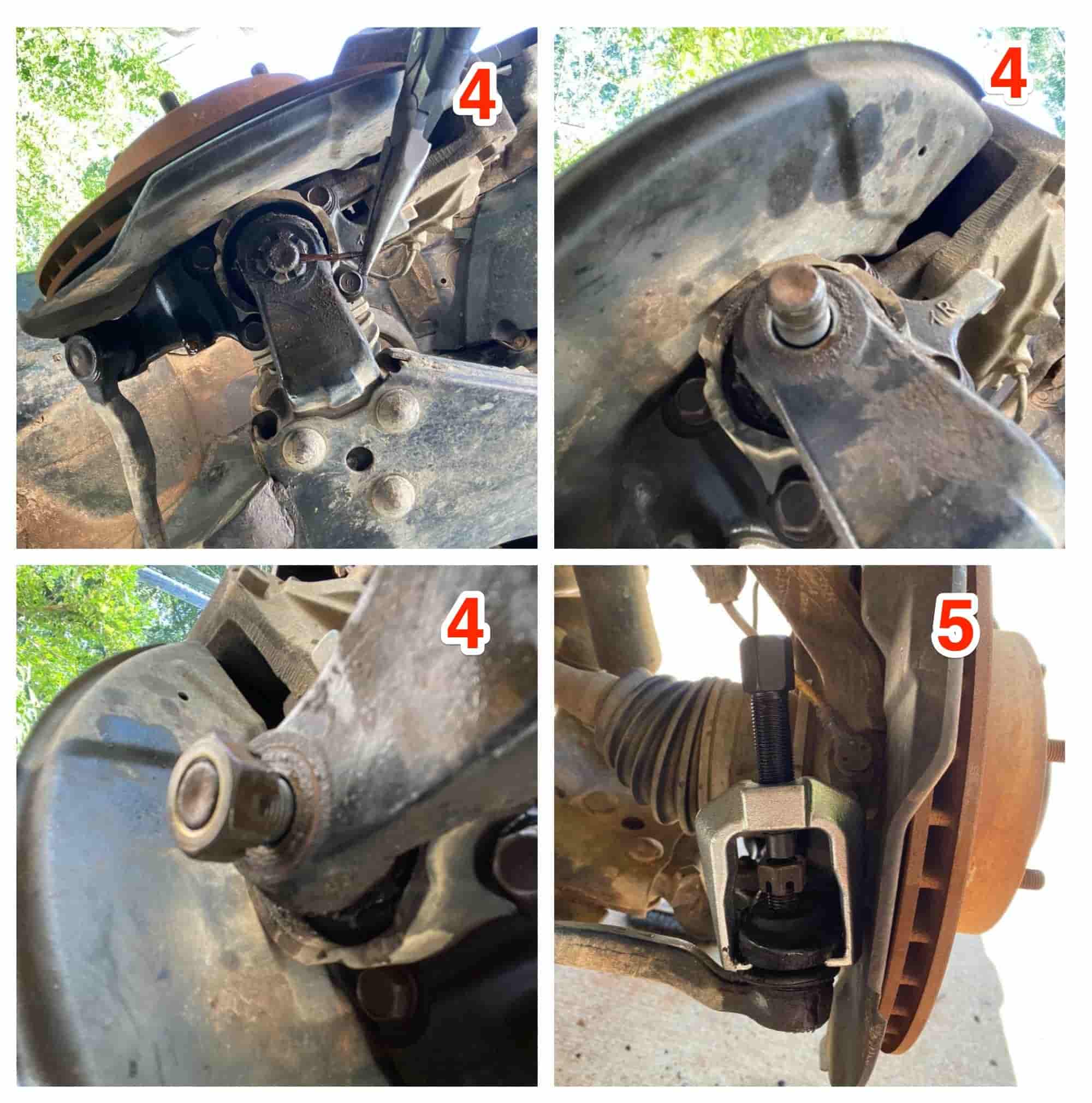

4) Remove the cotter pin from the LBJ castle nut and loosen the castle nut bolt using a 24mm socket and ratchet. Use a breaker bar if the nut is stubborn (it is very tight). Once it is removed, thread the nut "up-side-down" so the release won't be as explosive when using the Pitman arm.

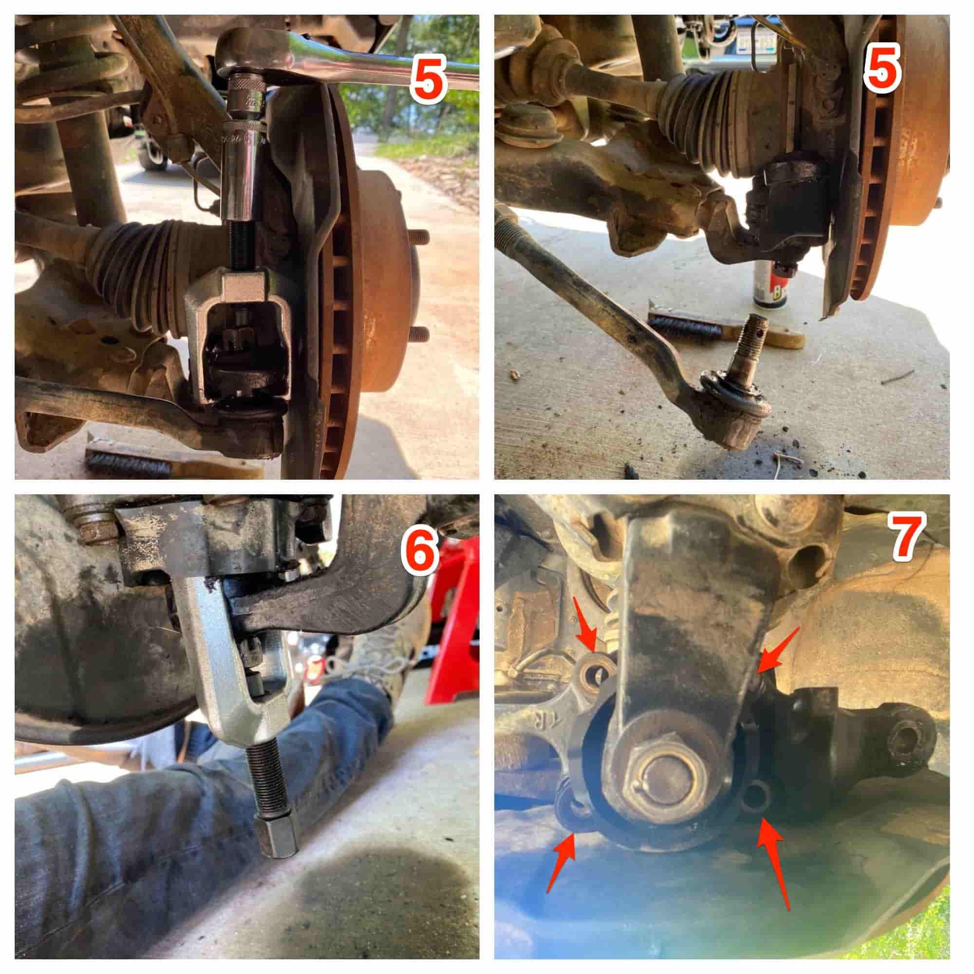

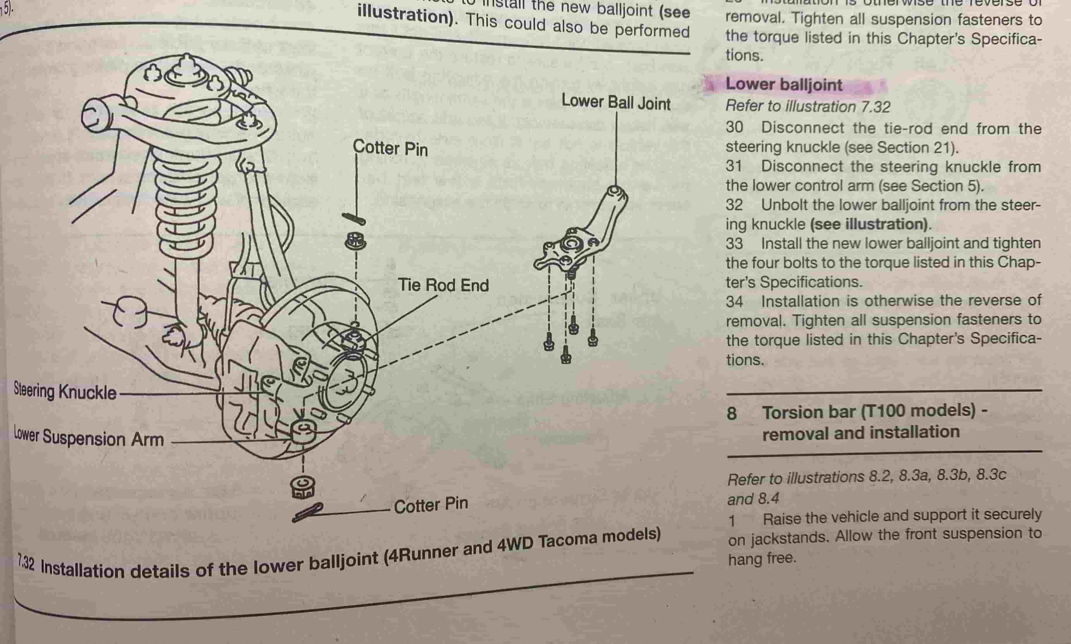

5) Use the Ball Joint remover arm on the outer tie rod to remove it from the LBJ. Use a 19mm socket on the Pitman arm to break free the joint. Remove the nut and outer tie rod from the joint. Don't lose this nut since you'll use it with the new LBJ.
6) Using the Pitman arm on the lower ball joint castle nut using the 19 mm socket to break the lower ball joint free. Once the lower ball joint castle nut is broken free. Leave the castle nut on.
7) Remove the 4 LBJ joint screws.

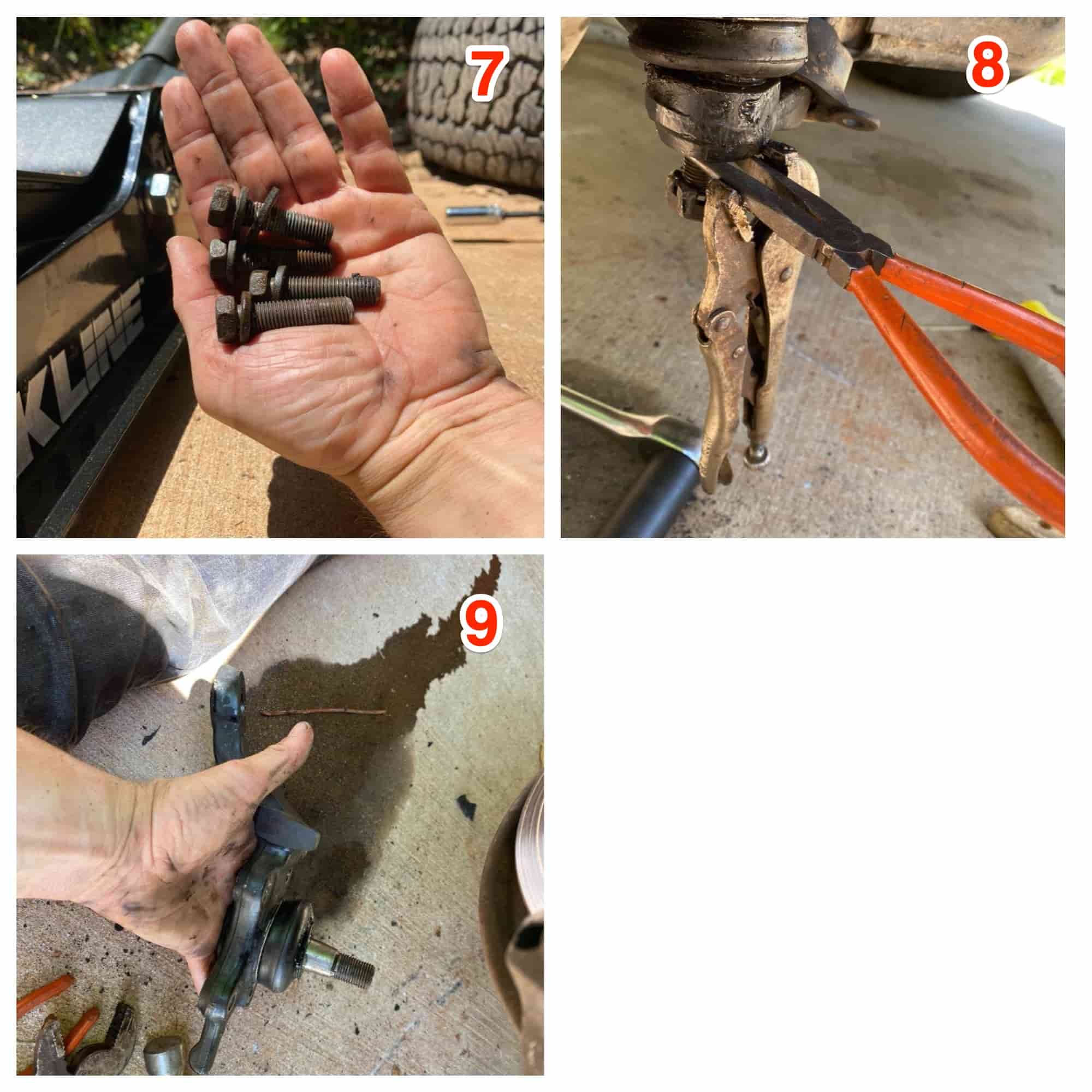

8) Finally remove the lower castle nut. I did have issues where the lower castle nut was spinning with the old ball joint so I went ahead and and improvised to get the lower castle nut removed.
9) Once all the bolts and nuts are removed, remove the old lower ball joint.

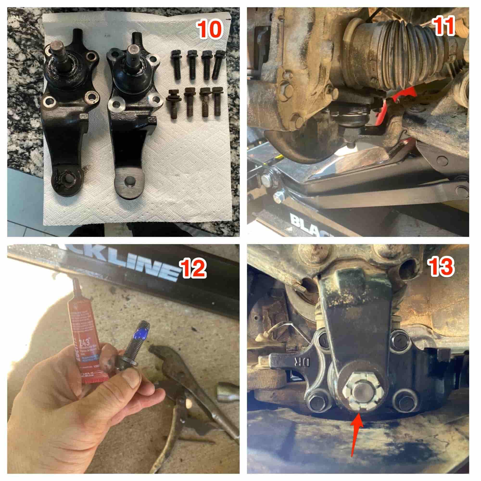

10) Spray all the areas with break cleaner so you'll have a cleaner surface area. Inspect the old and new ball joints and bolts and ensure they are the same.
11) Place new LBJ in place and start new low castle nut tightening by hand. Use the jack to raise the lower control arm and line up the steering knuckle and to rest the new LBJ in place.
12) Use Locktite blue on the four bolts on the LBJ and start to hand tighten them into place.

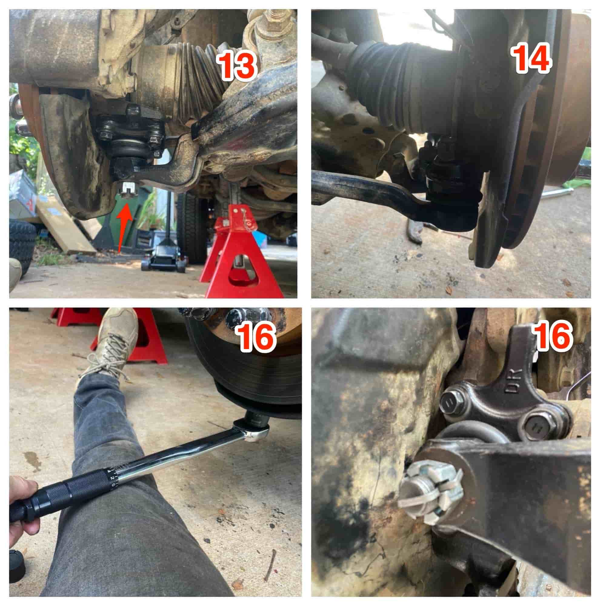

13) Tighten the lower castle nut by hand until tight.

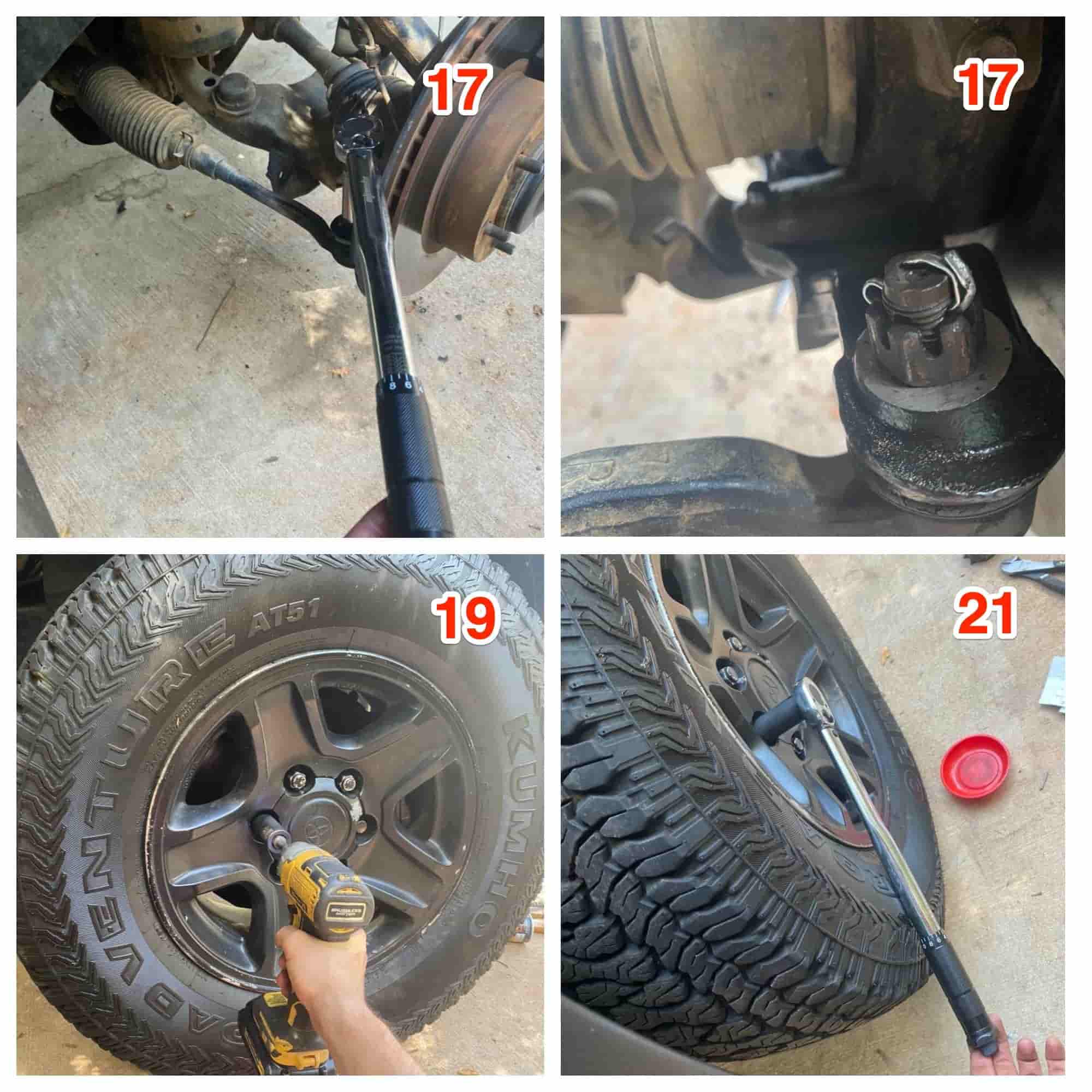

14) Put the tie rod back into the joint and snug up the castle nut that you removed initially.
15) If you're using the jack, lower the jack from lower control arm.
16) Tighten the lower castle nut to 105 ft/lbs and place the provided cotter pin. You might have to "over tighten" the castle nut to get the cotter pin to line up.
17) Torque the tie rod castle nut to 67 ft/lbs and use a new cotter pin from the assorted kit.
18) Torque the four LBJ bolts to spec at 59 ft/lbs (96-00) or 37 ft/lb (01-02) in a criss-cross pattern. Don’t over tighten your bolts 01-02 owners!!
19) Put the wheel and tire back on and hand tighten each lug nut.
20) Using the jack, raise the vehicle up to remove the jack stands. Once they're removed, slowly lower the vehicle until it's back on the ground.
21) Tighten the lug nuts to spec at 83 ft/lbs.

EDIT: As I’m doing the other side, the “up-side-down” castle nut technique is not really necessary. Using the Pitman arm directly against the bolt works just fine. Just take it slow.
