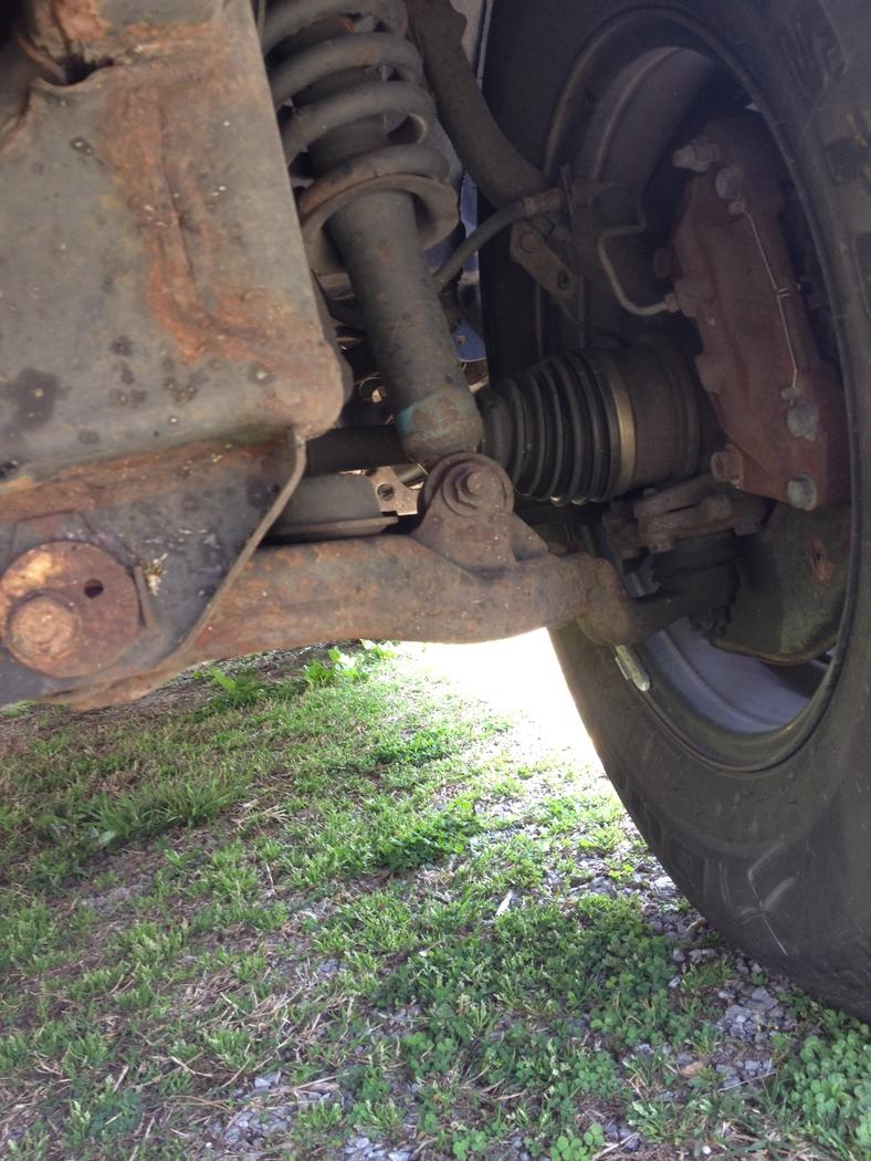

What's the name of this part?
The bushing for this bigger metal part on the driver side is loose and makes a knocking sound occasionally when I turn. I also noticed that the sway bars need to be replaced.
My local O'Reilly auto parts employee said this was called a tie rod...obviously it's not.
Will I necessarily need to replace this entire part or can the bushing be replaced without too much fuss? Is the junkyard my only option?
Any links to the part would be greatly appreciated.
Thanks friends!
It's the lower large part that connects to the wheel. The large bolt on the far left if the one that's making the knocking sound. It is sort of a "wish-bone" shape. Thanks for your response.
That would be the lower control arm. From what you described it sounds like the bushings are shot. Looking at the condition I would guess they sleeves are seized as well. Your best bet would be going directly through Toyota for replacements. You can buy bushings aftermarket, but if your sleeves are seized, OEM Toyota bushings with new sleeves already in them are probly your best bet.
Here are the Toyota part numbers. You'll want two of each.
48061-35050
48061-35040
Best price will be at Toyota of Dallas. They will ship to you. And they do need to be pressed in.
Good luck!
Thanks for your help, I really appreciate it. That picture represents what Illinois winters do to vehicles with the massive amount of salt they put on the roads in the Chicago area. I'm in Tennessee now so that should stop.
