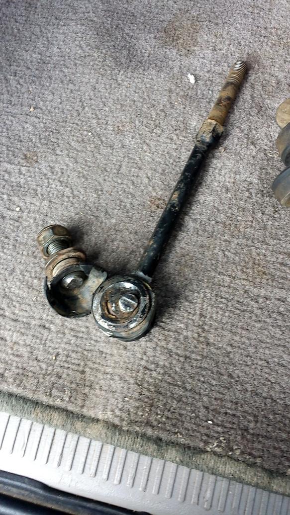

Well, I figured out where my noise was coming from. :-/ Hoping rotating the springs might fix it but the overlap is pretty bad. Thoughts? Gonna take the tires off and check all the ball joints and what not tomorrow anyway.

I know exactly what this is. You are using a top plate spacer, and you are over extending the suspension. When it droops the spindle is hitting the coils. this is a common problem if you use a top plate spacer, or if your spring is wider than the stock spring. sure you can rotate the spring, but you aren't getting anything out of having it lifted that high, you probably have no flex or down travel at all.
D Farms, yeah pretty much the problem I got myself into. Trying to figure out a solution without having to redo the whole set up.
Rock_Rat, I'm same as the OP I just got tired of messing up my log in so i changed the user name to match mine on other forums.
