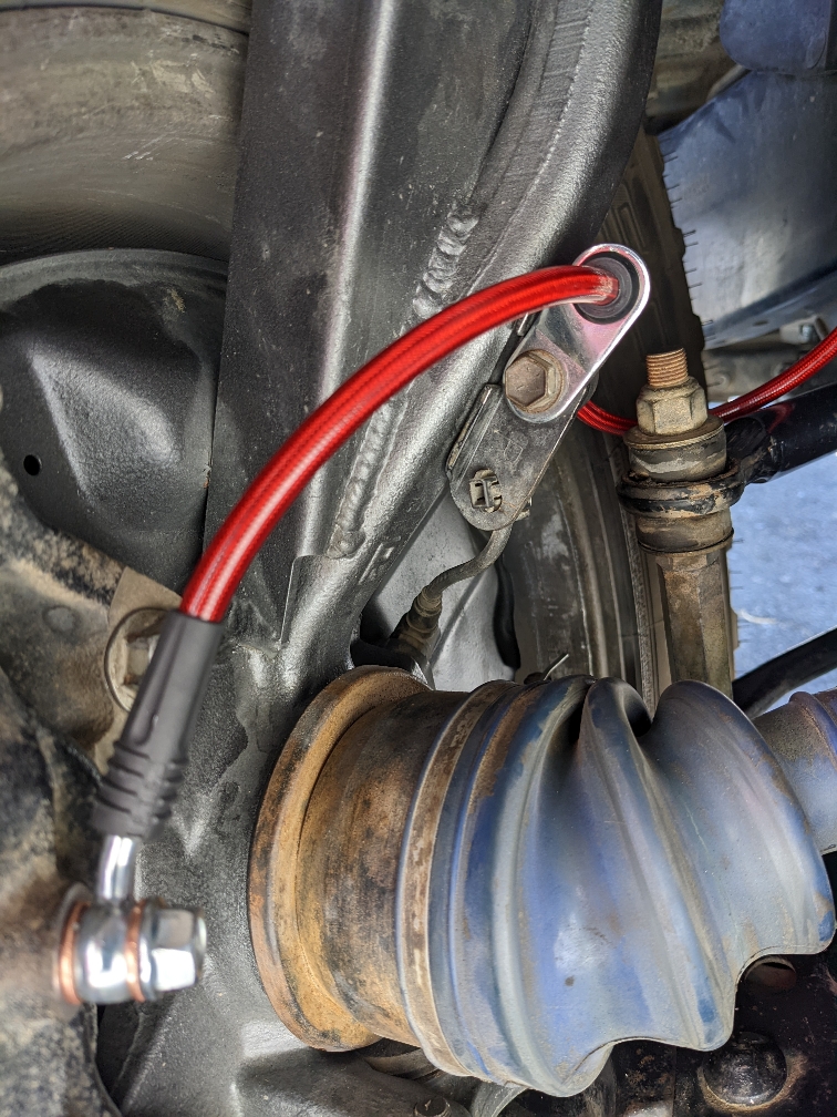

I splurged on SS Braided brake lines. (I needed longer lines because of my lift.)
Stoptech is definitely a reputable brand for sure. The link I left you is for Wheelers Off-Road. I've got the same ones in the front and rear. Either or are a great choice.

I bought the front StopTech SS lines off the Walmart website. I bought the rear StopTech lines (+2”) from Low Range Off Road because they were only $36 shipped, cheaper than from Walmart.

I have a set of these been waiting to go on. They look to be very high quality. I have installed a few sets of Steel braided lines, and they look as good or better than anything else I have installed.

I’m a little late to the party, but I ordered braided steel brake hoses for the front for a 1st gen Tacoma. It eliminates the hard line at the caliper, but does require a banjo bolt and copper crush washers for the new brake line to bolt to the caliper.
... braided steel brake hoses for the front for a 1st gen Tacoma. It eliminates the hard line at the caliper, but does require a banjo bolt and copper crush washers for the new brake line to bolt to the caliper.
If you buy the 1st gen taco lines from Stoptech, Toytec or Wheelers they come with the banjo bolts and very thin copper washers.
I found O'Reilly's has a banjo bolt and washer kit for $4 that has thicker washers - many threads about banjo bolt being too long and not sealing.
I also found 1.5mm thick M10 copper washers on Amazon for a good price ($9 for 30)
