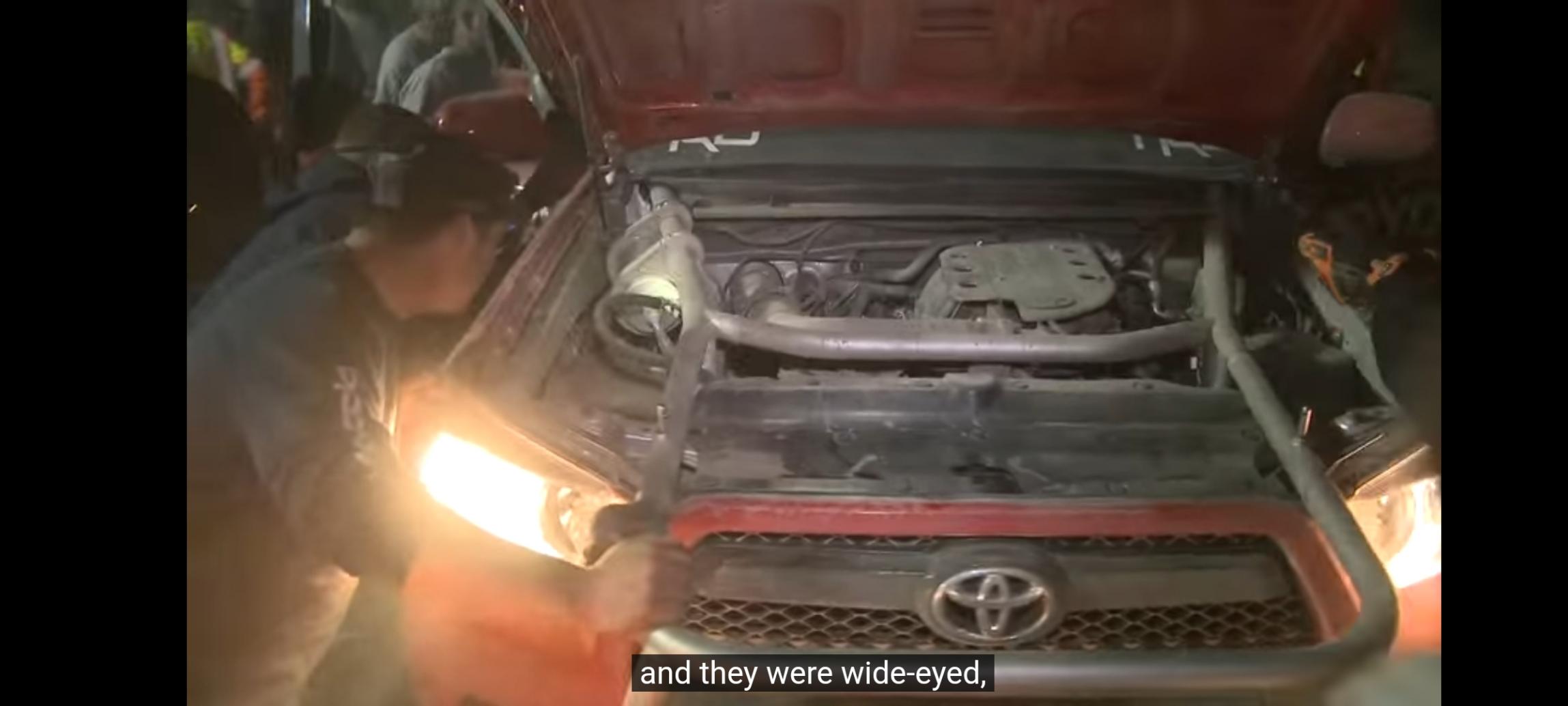

Baja1000 youtube
In Google - search for Baja1000 - 5th Generation Toyota 4runner.
Several videos about upgrading the frame (adding a role cage that extends from the passenger compartment into the engin compartment). Probably one of the rules of the race....fun videos to watch.

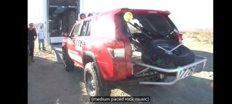

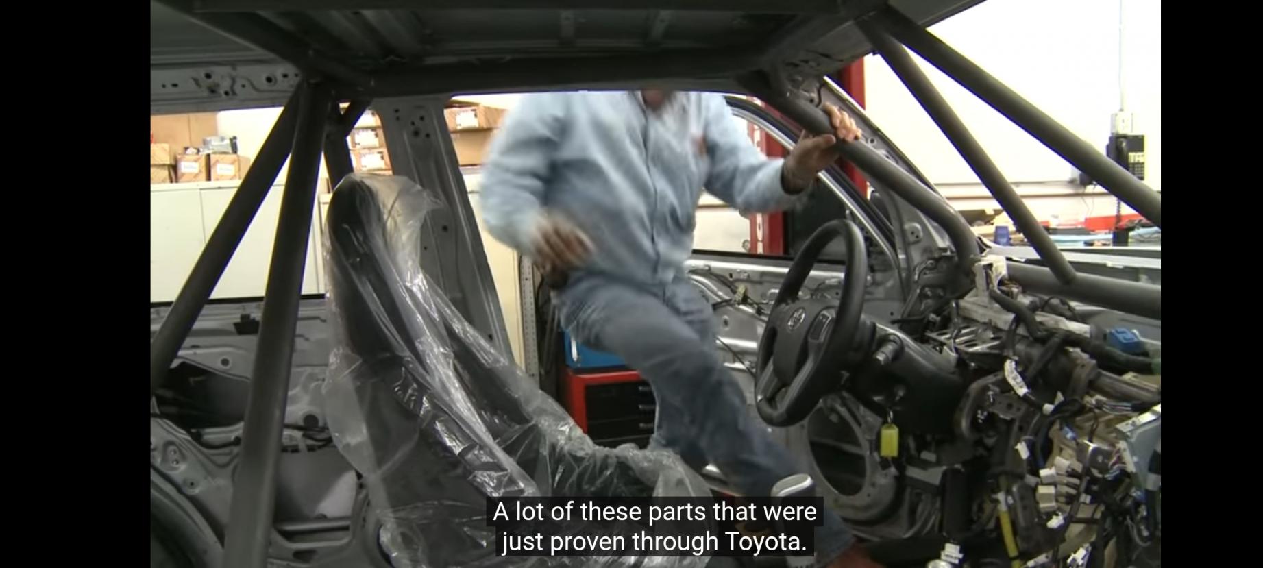

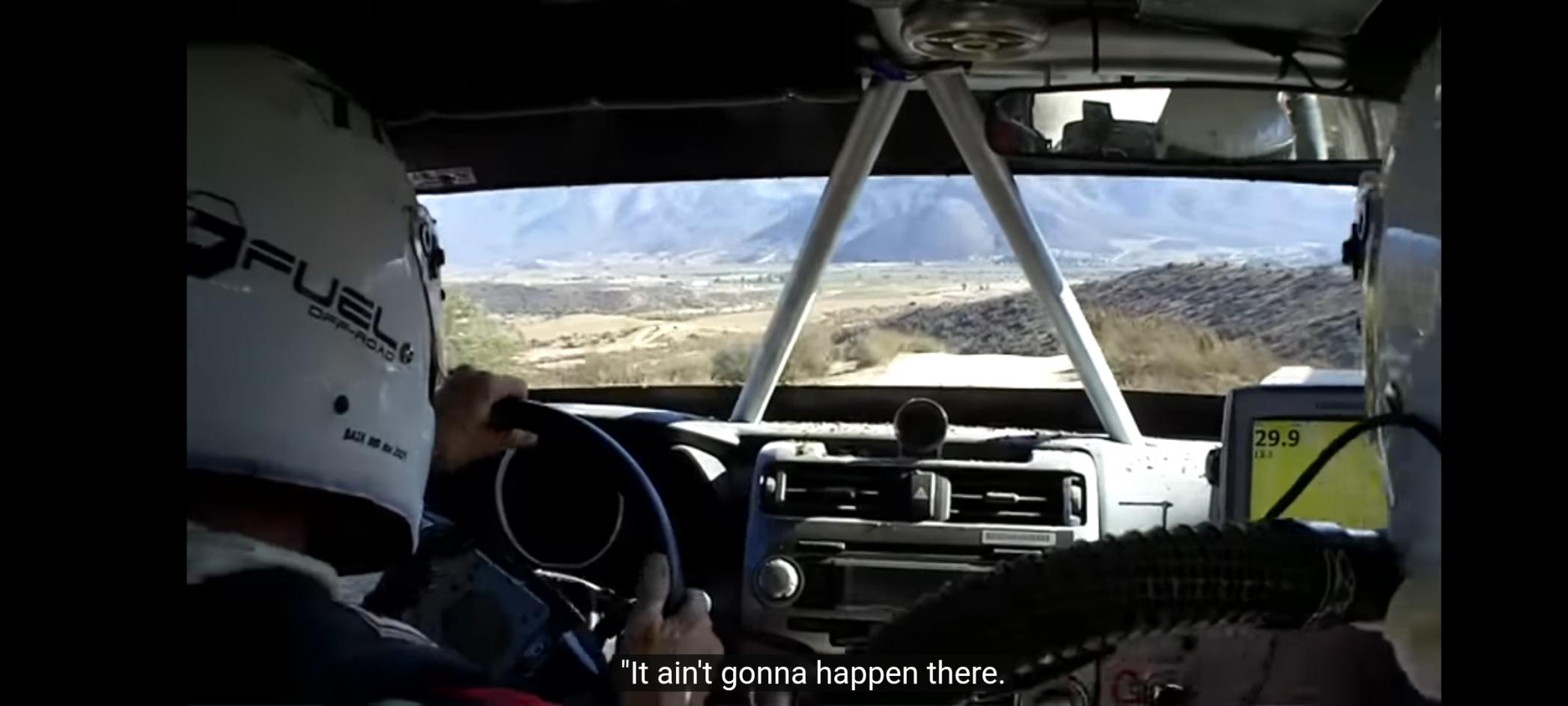

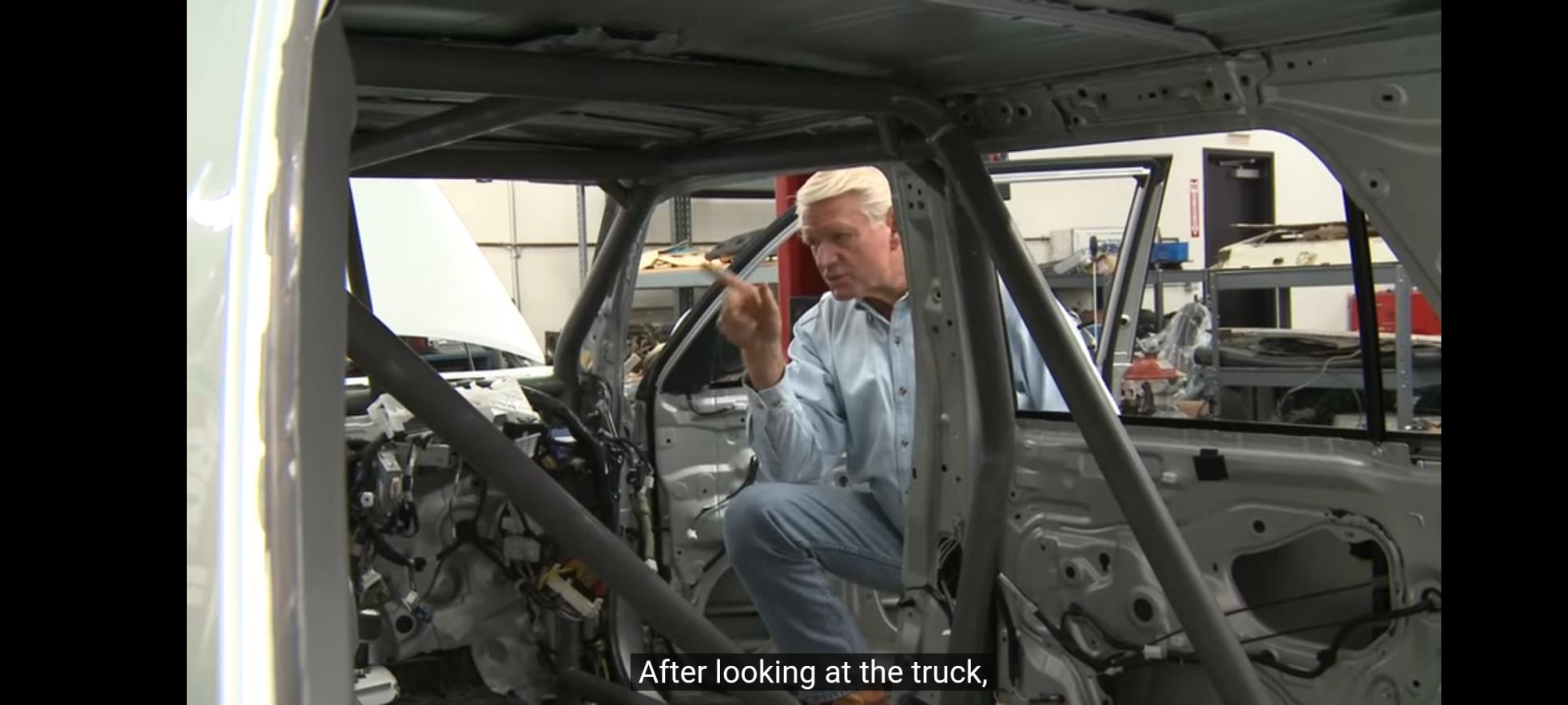

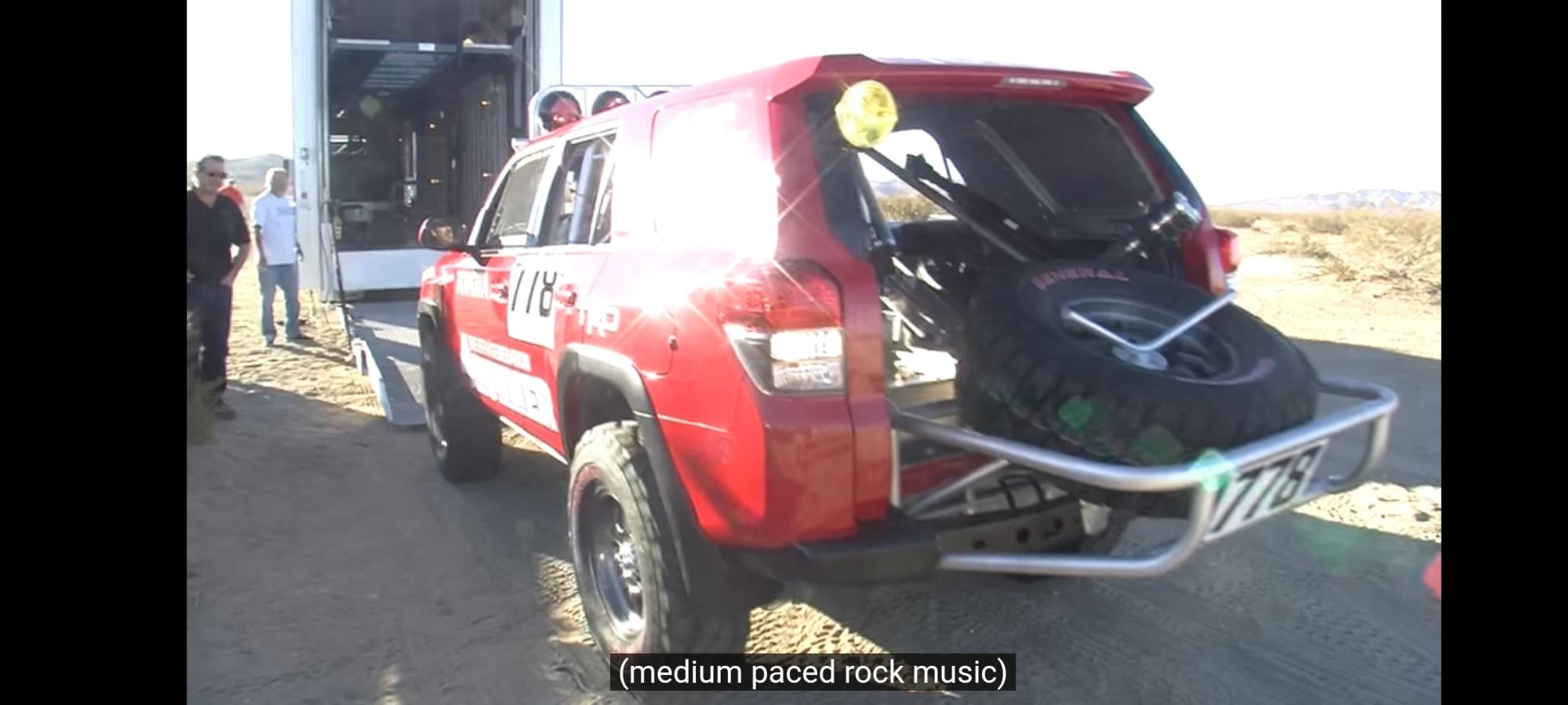

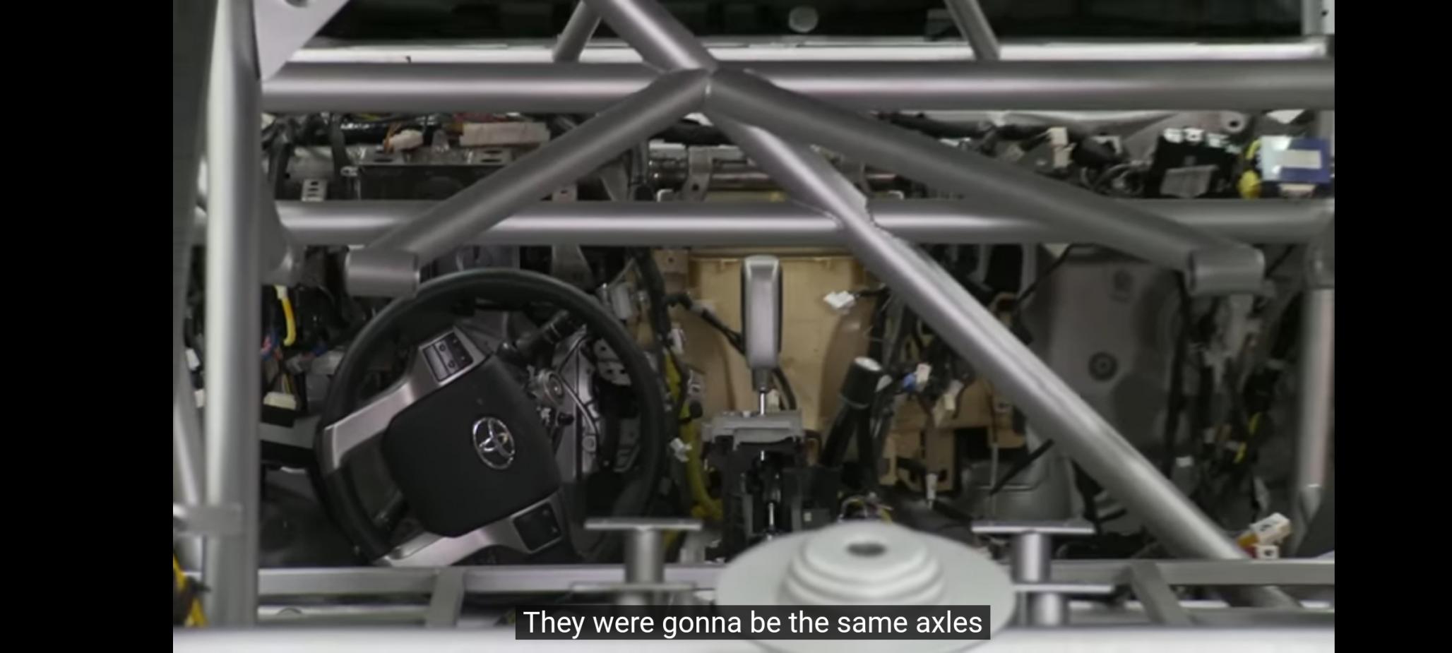

Posted some screen grabs... is this what you had in mind (or some version)?
