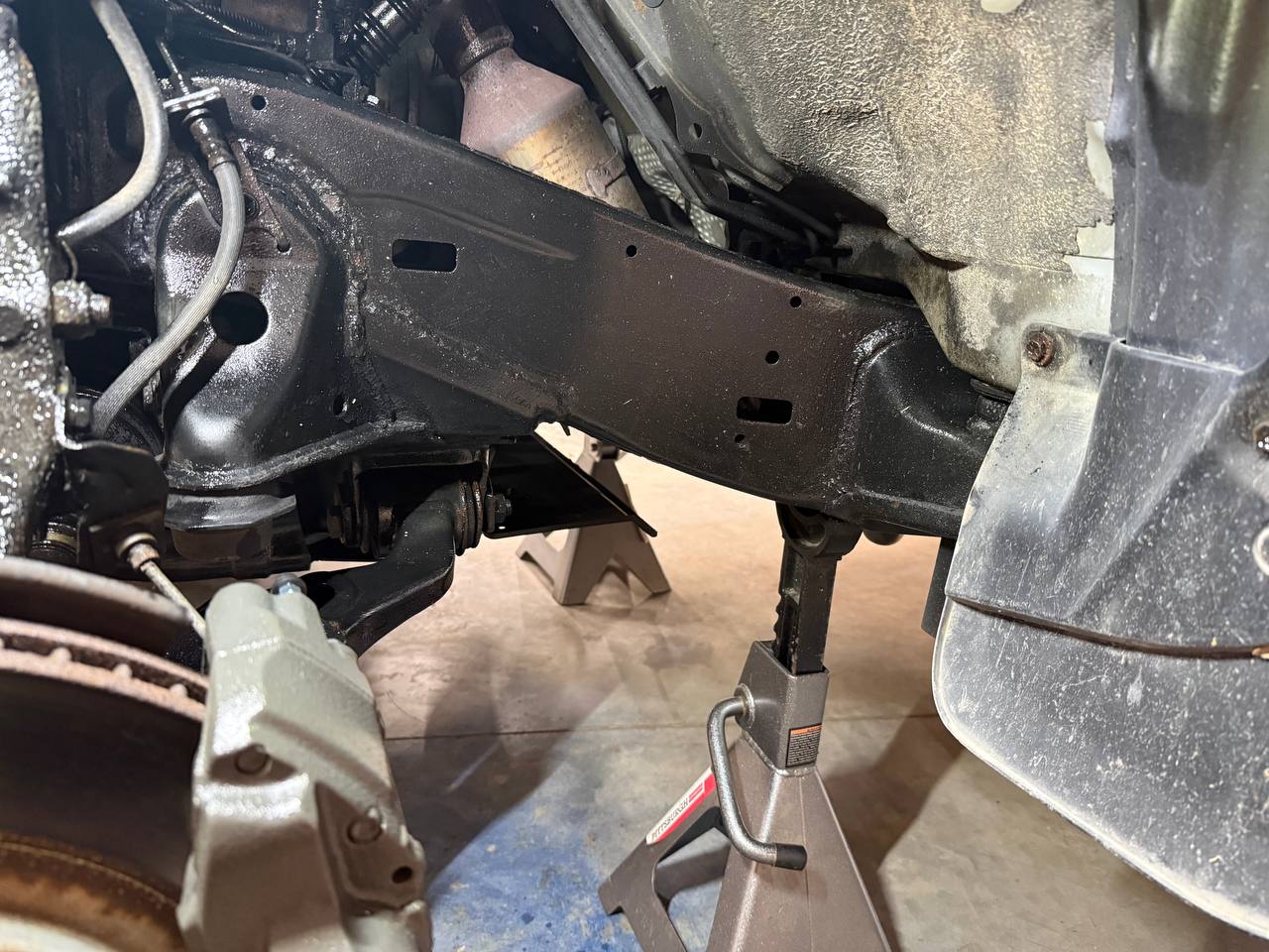

If you look at your frame closely you will notice that it has about 100 factory holes in it (no exaggeration). This allows road spray to enter the frame during normal use, whether on road daily driving in the rain/snow/salt, or off roading crossing streams and mud holes. Our frames are going to get all kinds of dirt/sand/salt and water in them and much of it stays there and starts the corrosion process. I've seen pictures on here and elsewhere of 5th gen frames that have factory installed plastic plugs in these frame holes and you can buy these frame plugs as a kit from Toyota, I have purchased two for about $60/each and there are still about 20 holes left to plug. It's late in the game for my '03 and it has been patched in two locations below the passenger front door. I have Fluid Filmed the inside as best I can and then installed many plugs using RTV to secure/seal them, hopefully I'm doing some good and not harm.
I have used old tranny oil ( or engine if out of TO ) to spray the undercarriage of my vehicles from the 70's, 80's ... to present day on an annual basis just prior to winter. Equipment required: spray gun w/pickup hose for the oil and a compressor. My '05 4R w/V8 's frame is still solid ( zero holes )albeit coated with surface rust. This was the method used by many shops to coat vehicle's undercarriage back in the days ( nowadays its Krown with its own specialised fluid ). I am in central Ontario Canada where salt on the roads for 6 months of winter is a given. Maintenance as in regular washes @ a DIY car wash bay as some had mentioned in earlier posts is key.
I've started using fluid film and it's incredible. Pressure wash, then use a wire brush to knock rust loose, then use rust convertor, then follow up with fluid film inside and outside the frame. Apply in summer so it has time to creep and polymerize a bit.
