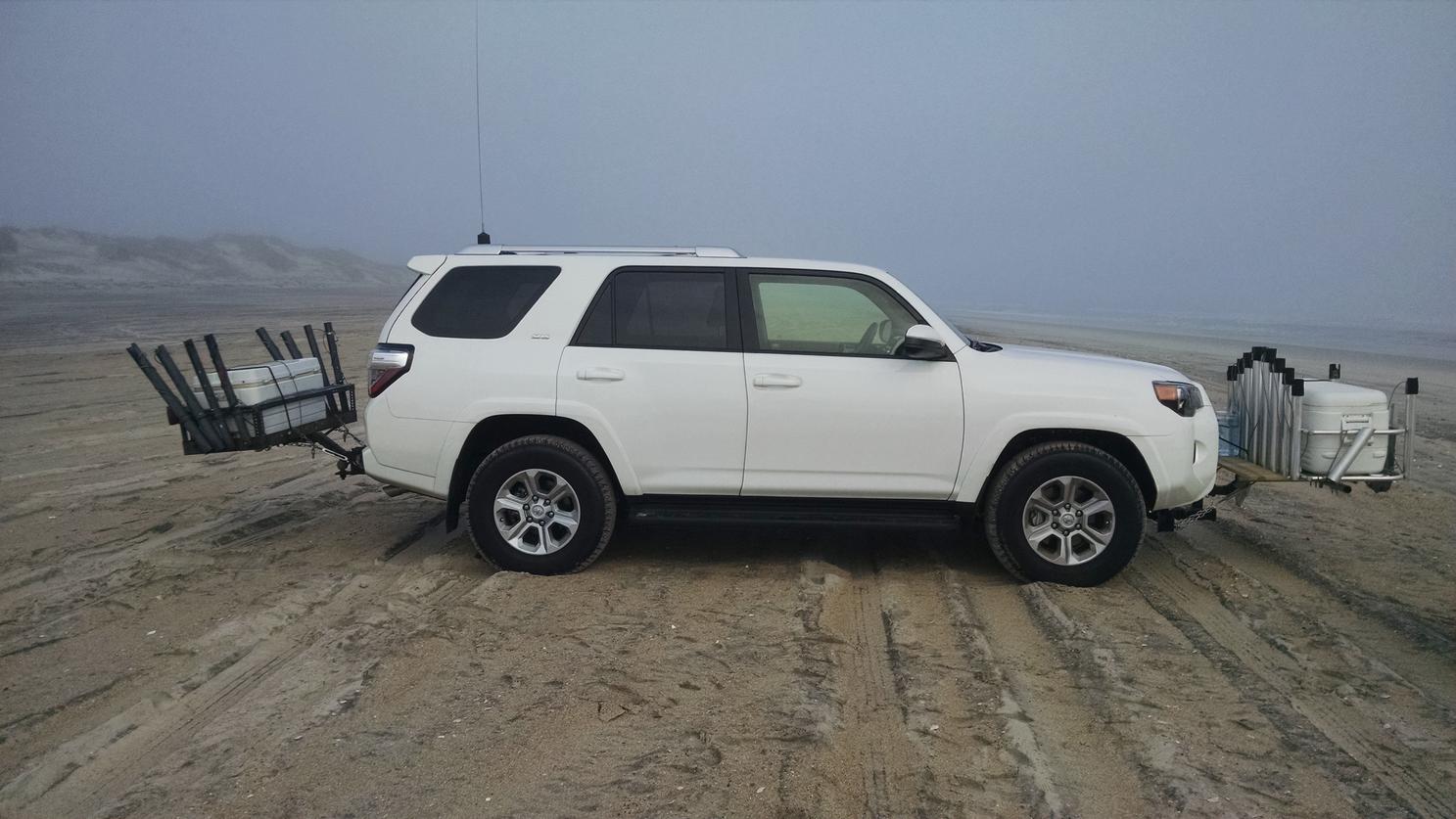

I never seem to have a bumper problem:biggrin1:

[MENTION=100784]Salvo Jimmy[/MENTION] - Thanks for posting your picture. I just ordered a Curt 31367 front hitch to attach my fishing rack on the front and a Curt 18153 folding rear basket to hold additional coolers on the back.
Recommend using one of these on the rear as I do. Will give you a much better departure angle going over ramps and cuts on the beach and it allows in my case to open the hatch back with coolers on the rack. Also allows me to stand between the rack and rear of vehicle with hatch open
BTW I also use the Z-bar on the front that raises the rack to give a better approach angle.

[MENTION=100784]Salvo Jimmy[/MENTION] - Thanks! I also have to worry about departure angles getting on and off the Ferry's when I head to CALO and especially Portsmouth Island. Depending on the tide, and erosion, you never have the same arrival/departure angles. I have seen folks get hung up on the deck of the ferry trying to get off. I plan on traveling to my location with the rear deck folded up and once I am on the island for 5 days, moving cargo from inside to the back. That way I free up the inside for sleeping! The warmer temps the past few years has made it necessary for me to bring more coolers with Ice to keep us going.
