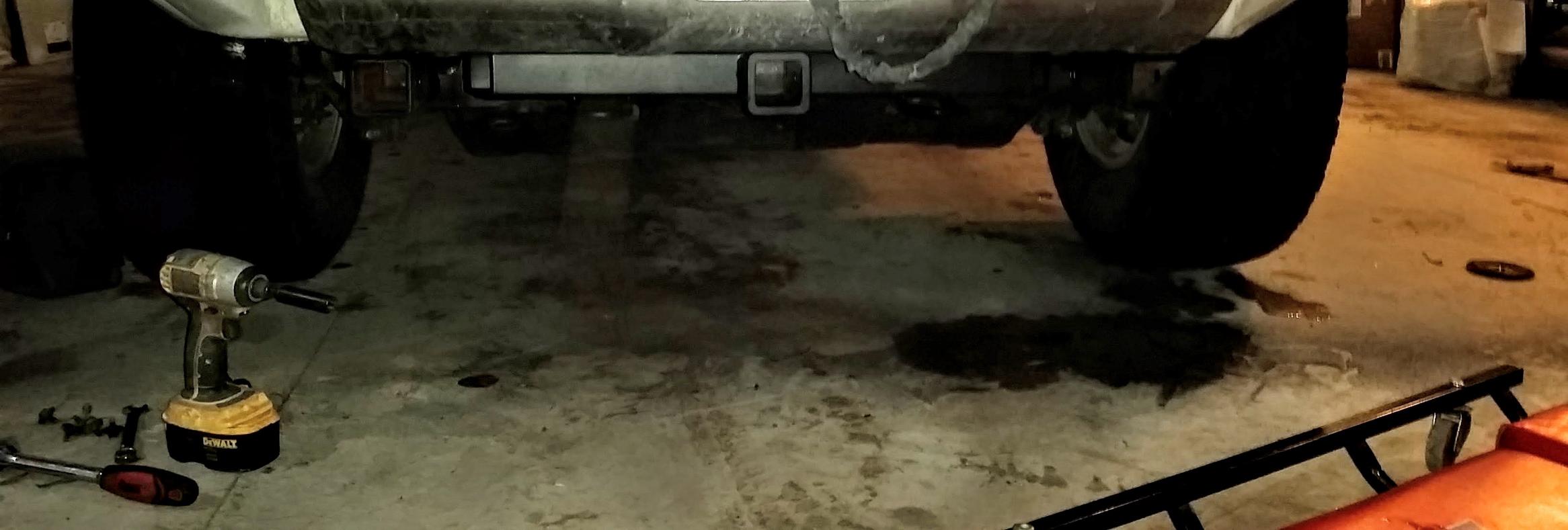

Here's how the older version mounted. It looks like the new one is similar. It's as tight as you can physically put it without having to cut the bumper to fit. (Mine is modified for some other uses, but you get the idea).

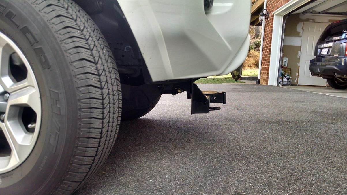

Here's a pic of the new one from the side. Don't be fooled by the angle making it look like the tow hook is below the receiver tube. It is at the same height.

That's a lot lower than the trail edition version. Probably 4 inches lower. Imagine that hitch touching the bottom of the bumper plastic. That's how mine fits.

You can just swap the hitch for a trail edition version. It'll fit just fine and give you back 4 inches of clearance on that hitch. Tuck it up to the bumper.
