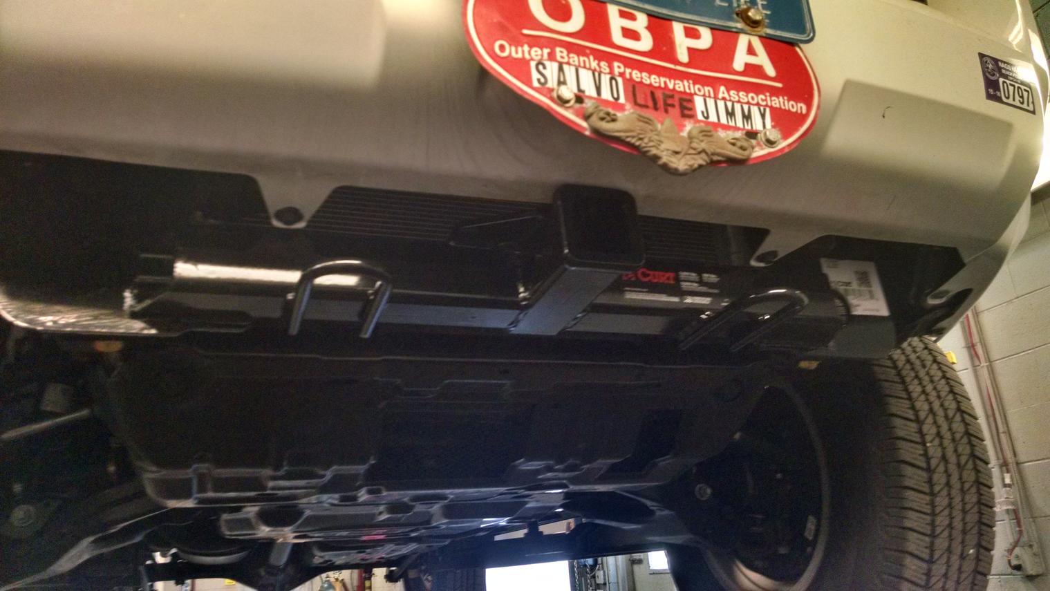

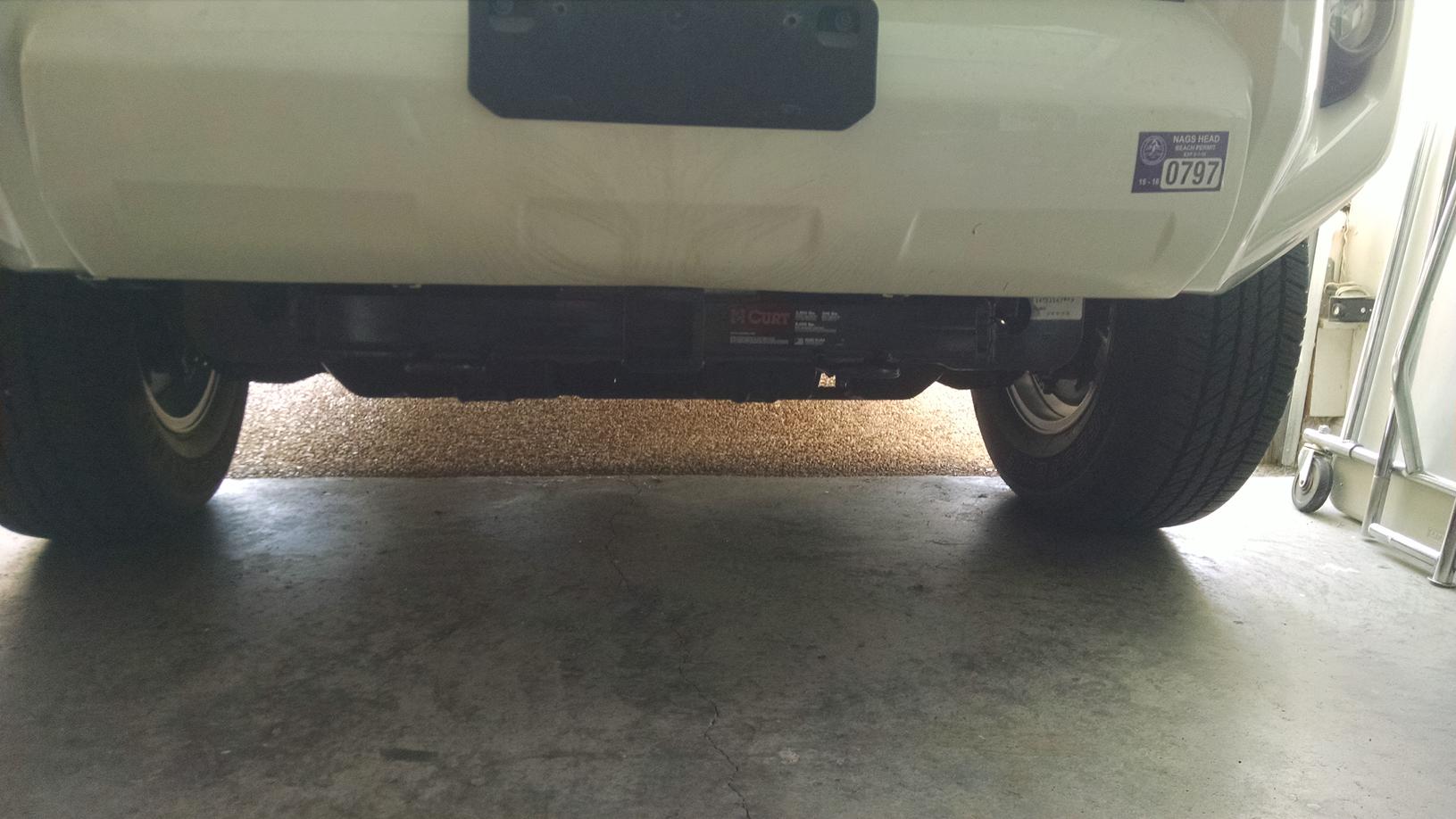

OK, I double checked that as Jetboy says the frame/bumper configure for 2015 trail is the same as my 2016 SR5. I took off the underbody panel and using a tape and level can see that the bottom of the bumper is about 3.75" below the center of the inboard frame bolt. Thus it seems that the receiver would clear the bumper by about 0.25". Even if my measurement is off by as much as 0.25" there seems enough flex in the bumper to accommodate even more error.
So I'm ordering a 31367. Pictures to follow, assuming it works.
OK, put on the 31367 today. No problem. Fits just as Jetboy thought it would, right up under the bumper. I did have to use the 2 longer frame bolts that came with the 31054 as the stock bolts were not long enough, as the 31367 instructions would indicate. Also had to use some larger washers as the hole size on the 31367 were marginal, in my opinion, for the stock washers.
And of course the underbody panel had to be left off, but the cross bar and receiver tube mostly fill the void space there, so that is not a problem.
I will have to get a Curt 8 inch extender 45791 to get the front of the receiver tube out past the front bumper.

Looks good! A much more compact fit. You can barely tell it's there. As an added benefit it's pulling force puts much less twisting force on the frame rail ends, so it should be stronger too.
