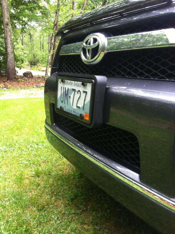

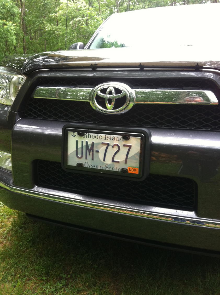

Could not get OEM front license plate mounting bracket. Co-worker just bought a Subaru Outback and guess what? With minor fitting it looks almost like custom made. $35.00 in a local Subaru dealer

Subaru bracket has 4 pads with 3M self adhesive tape and two holes to screw in to the bumper. Those two holes perfectly correspond with existing holes in the bumper (from dealer attaching the license plate in the first place). 3 out of four pads with 3M tape are touching bumper , so I used them too to assure a solid attachment to the bumper.
I had to file off a bit of vertical sides (less that 1/8” in the center) of the mounting plate to follow the curve of the 4runner’s bumper.
A also used Weathertech license plate covers to protect the plates.
