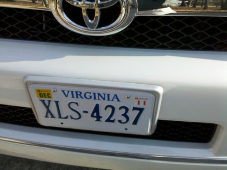

Same with mine...just straight into the bumper. I have a feeling I'm going to have to add brackets at some point.
Same here. Mine was drilled right through the bumper cover into the bumper. I didn't like my plate rubbing right on the paint, so I installed and Audi plate bracket I had laying around. It is silver, but looks better than the plate right on the bumper cover.
If my bumper was not drilled already, I'd stick the bracket on with 3M tape and not drill it.

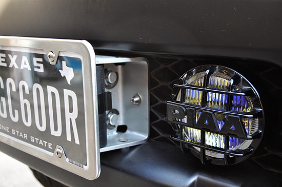

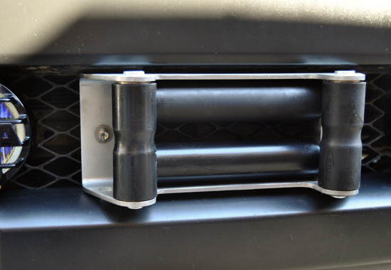

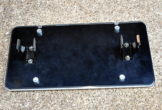

I copied from the Jeep guys and bought the bracket that mounts to a roller fairlead. You could also just get some brackets and mount the plate backing to the grill with bolts and large flat washers. It sits back in 2 1/2 inches in the middle of the lower grill. I'm making some ss brackets tonight to mount it without the fairlead until I get my winch put in.
That is BAD A$$!!!!!!
Thanks for the feedback and the options. I'm going to play with it more this weekend. The standoff type mount would be cool, I hadn't even thought about that :bigok:
